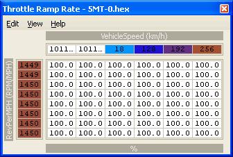

Old Oct 15, 2011 | 07:01 AM
ikoval's Avatar
Joined: Oct 2011
Posts: 1
From: Ukraine
In 53040007 case I'm getting something that does not look like right data. Can you please take a look on that?
Requested Torque/Throttle Ramp Rate Tables-throttle.jpg

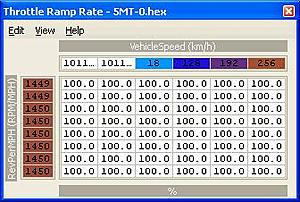

I have used xml quoted below.
Originally Posted by tephra
5304/5305:
Code:
<scaling name="Percent" units="%" toexpr="x*100/255" frexpr="x*255/100" format="%.1f" min="0" max="100" inc="2" storagetype="uint8" endian="big"/>
<table name="Throttle Ramp Rate - SST Normal Mode" category="Throttle" address="5f519" type="3D" swapxy="true" scaling="Percent">
	<table name="VehicleSpeed" address="62328" type="X Axis" elements="6" scaling="VehicleSpeed"/>
	<table name="RevPerMPH" address="626b6" type="Y Axis" elements="8" scaling="RPMPerMPH"/>
</table>
<table name="Throttle Ramp Rate - SST SPORT Mode" category="Throttle" address="5f4e1" type="3D" swapxy="true" scaling="Percent">
</table>
<table name="Throttle Ramp Rate - SST S-SPORT Mode" category="Throttle" address="5f4a9" type="3D" swapxy="true" scaling="Percent">
</table>
<table name="Throttle Ramp Rate - 5MT" category="Throttle" address="5f471" type="3D" swapxy="true" scaling="Percent">
</table>
