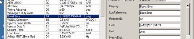

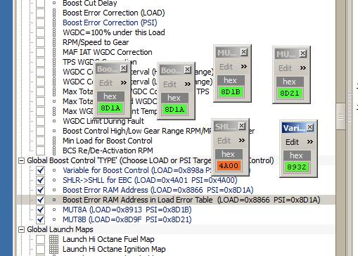

hi all,
V7 95630706
cannot log the following:
Boost Error
WGDC Correction
my current settings:
Attached Thumbnails Evoscan logging problem-mutt.jpg   Evoscan logging problem-scan.jpg   Evoscan logging problem-flash.jpg

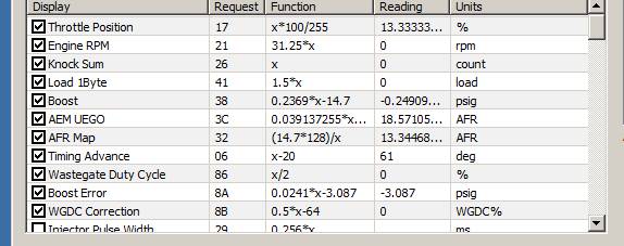

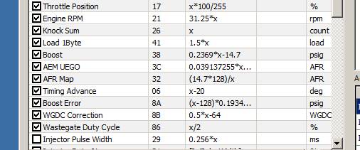

ok here's a few more tables.
I'm using Omni 4Bar sensor
Do formulas look correct.
evoscan:
Attached Thumbnails Evoscan logging problem-ecuflash.jpg   Evoscan logging problem-evoscan.jpg

If your WGDC map was spot on then boost error would be 0. Can you post your boost adder, desired boost and WGDC correction tables?
Old Nov 8, 2011 | 03:38 PM
catman78's Avatar
Joined: Oct 2010
Posts: 402
From: L.I. New York
Thanks for chiming in Raptord.
Here's what I have.
I'm @ sea level.

Substituted your formula for boost err correction.
with ignition on, Boost(Omni) reads as follows:
Old Nov 9, 2011 | 05:48 AM
Raptord's Avatar
Joined: Mar 2009
Posts: 3,525
Likes: 20
Change the 14.7 in your OMNI formula for a 14.5. Unlikely that that's the problem but it'll get your logged boost closer to what it actually is.

thanks, will do. I was under the impression 14.7 was used for sea level?
Old Nov 9, 2011 | 07:18 AM
Raptord's Avatar
Joined: Mar 2009
Posts: 3,525
Likes: 20
Usually yes, but weather etc can make it vary a bit. Mine is 14.5 as well and I'm pretty much as sea level.
