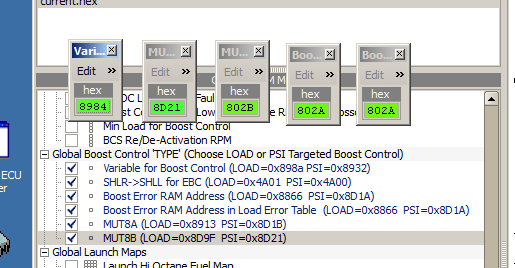

I could never get either LOAD error or WGDC Correction to log correctly
in Evoscan.
So going back the original thread I changed my addresses in ECUFlash to
EDM Evo VIII 96530006
https://www.evolutionm.net/forums/ec...trol-mods.html
The hex values listed for LOAD in TephraMOD-96530706-v7 definition header NEVER worked for me.
Changing the values to the following, now Load error and WGDC log correctly:
Yeah, I had to change all of my boost parameters for load in all of my V7 roms as well. The values for LOAD were the OEM values, not the true LOAD control values that MrFred originally listed, while the values for PSI were correct.
