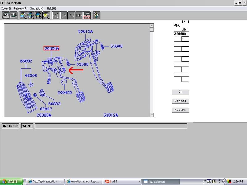

Also, get underneath the dash and make sure your upper clutch switch is fully depressed when the clutch pedal is as high as it goes. Otherwise, it will take the slightest breath on your clutch pedal to activate the NLTS.
