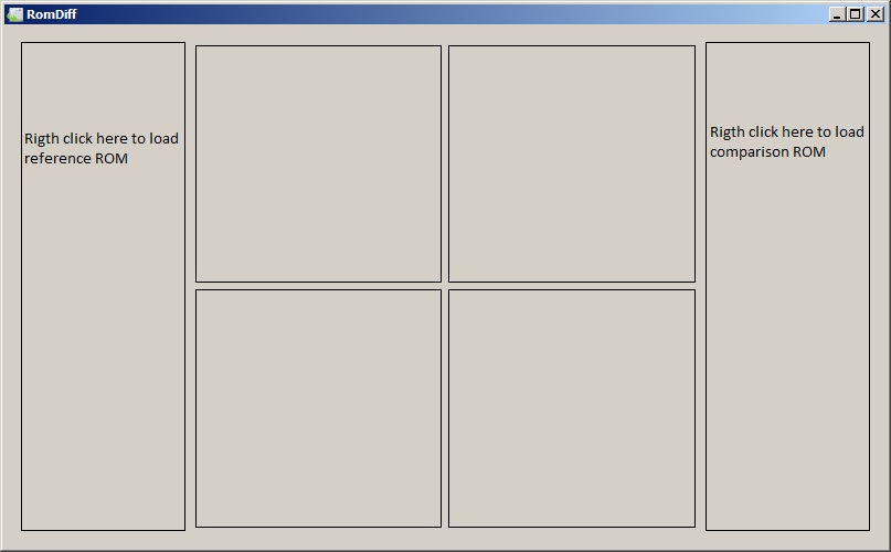

Since Colby probably develops some similar tool, I will attach what I have till now.
Rename RomDiff.bin to RomDiff.zip (damned site upload rules)
Tool assumes you have intalled EcuFlash in default EcuFlash location.
To those who just want XML parsing, use ILSpy, Reflector or other .Net disassembly tool to get a peek at the code.
@ziad: I may send you the code if you need it in your LiveMap
Known bugs: 1.Static Axis is not yet supported,
2.XMLs have to be well formed, exception otherwise
(e.g. I have found a problem in my 88590015
<table name="Target Minimum Idle"address="3d24"> where a space was missing)
Here is a little how to use:
