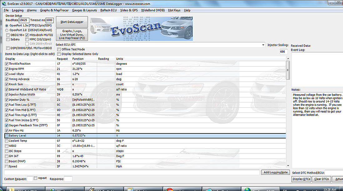

I saw that if you didn't have the injector pulsewidth above the duty cycle, the duty cycle will not log. Is there something similar with the fuel trims, if you don't have them in a certain order they don't log?
I have attached my ROM and a screen cap of how i have things arranged in Evoscan.

The only trims that shouldnt work if disabled in periphery are the LTFT and you dont want them on anyway. If you dont have the STFT look at the O2 sensor voltage and make sure its cycling. If it is kind of cycling (not stuck at 0.0394v) there is always the possibility you are way on the wrong side of the trim range (-25/+25) one way or another.

The LTFT trims are not working but the STFT is logging just fine, it cycles with no issues.
I was following the "how to tune your evo" thread and getting the low and mid LTFT's within the +/-5%
