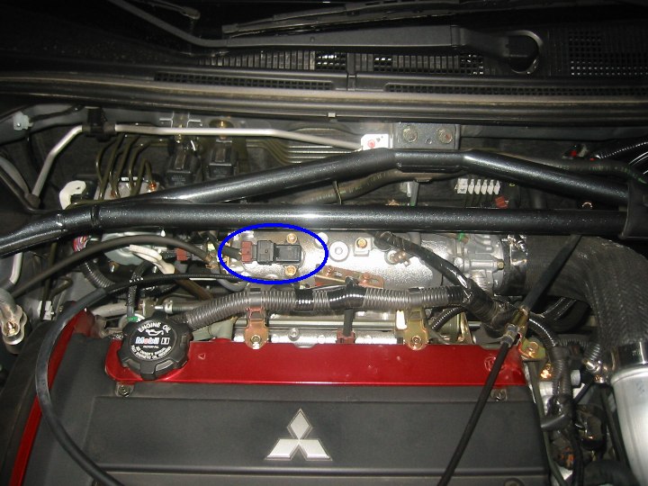

Here is a picture of the MAP sensor location (right on top of the intake manifold):
To remove the electrical plug, slide a thin blade screw driver under the metal retainer clip, and it will easily pry up. It is spring loaded, so it will go flying if you don't keep your hand on it when removing it.

Attached Thumbnails log boost with JDM MAP sensor (updated instructions)-map-sensor_web.jpg

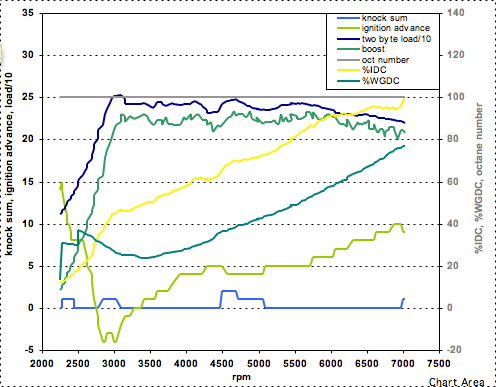

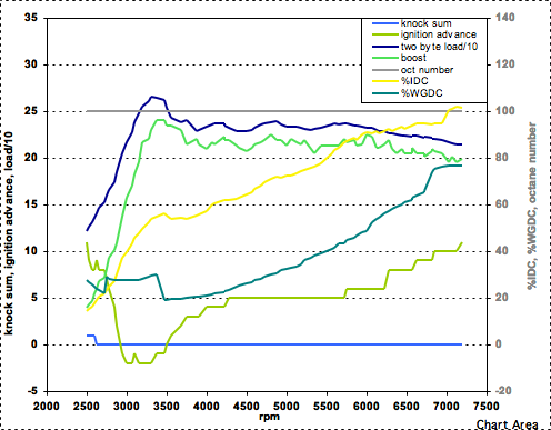

All my logs so far with the JDM sensor and 2 byte load show that load tends to follow the boost response.
3rd gear WOT run:
4th gear WOT run:
