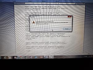

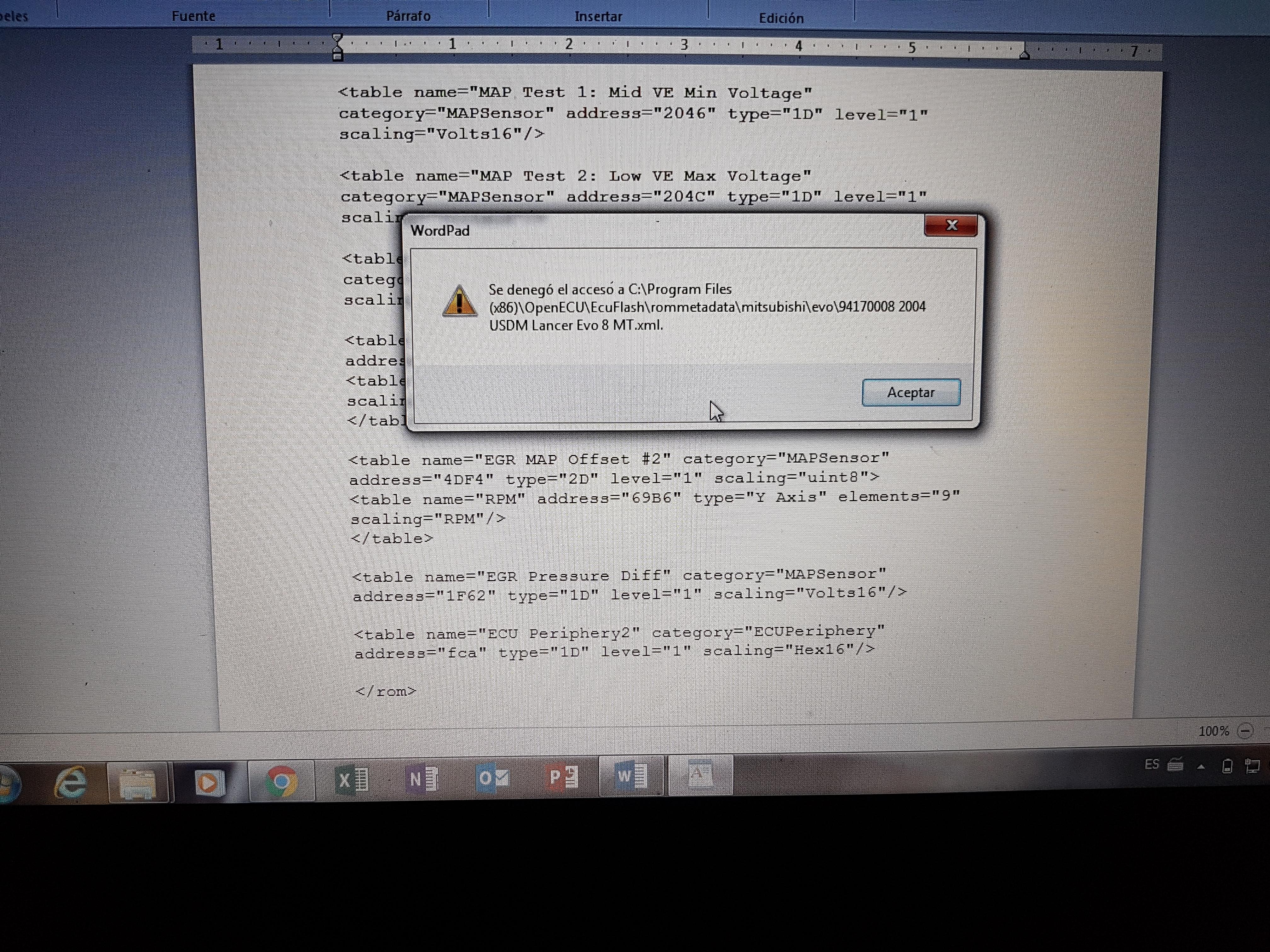

Friends could someone help me out here. I changed the map sensor and iam trying to add the definitions to the ecuflash but when i copy everything and try to save it it says it cant be saved so it doesnt change the definitions and i cant access de map tables to change the values. Please help. Thanks

What if i disable the egr test? Will the car be ok?

Solved it thanks.
