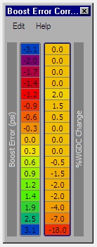

4) Instead of BDEL, BCLO, and TBEC tables, there are now "Baseline Boost", "Boost Adder", and "Boost Error Correction" tables. These tables are in psia.

<table name="Boost Error Correction" category="Turbo" address="3f20" type="2D" level="1" scaling="OffsetWGDC">

Boost Error Correction: This is equivalent to the TBEC table. Use the values I list below as a starting point. The upper right value should be set to zero, otherwise, significant boost overshoot may occur.

The "WGDC change" values in the BEC table represent only *incremental* changes to the *total WGDCC*. Say for instance that you are using the following BEC table:
-3.1 0
-2.0 0
-1.4 0
-1.2 2
-1.0 2
-0.8 1.5

Zero out the right hand side of the BEC table as shown in the figure below (figure has not yet been added). This will prevent the ECU from feedback loop from making changes to the WGDC.

Reactivate the feedback loop by inserting WGDC change values into the right side of the BEC table. The table that's currently working well for me is shown below. It will only work well if you've gone through the BWGDC tuning procedure. It should work well for most people, but you are welcome to try to fine-tune it yourself. That's what this whole forum is about, eh. :-) If you decide to make up your own BEC table, the most important thing to watch is the BoostError. This will tell you how far you are from your target boost value. The WGDCC is of secondary importance.
My current BEC table that is designed to work with a correction interval of "1"

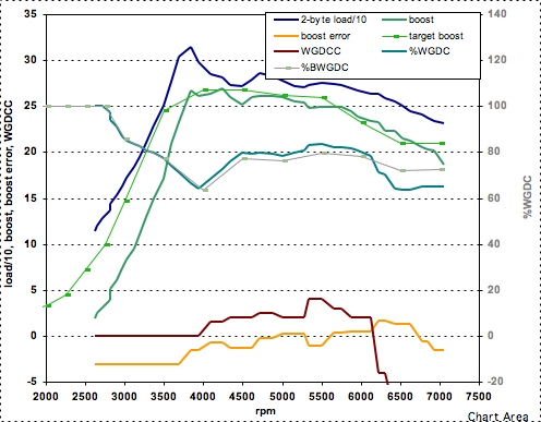

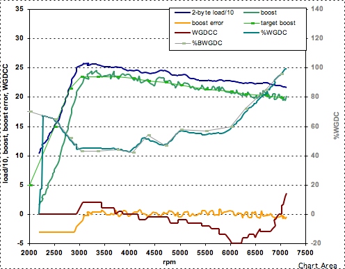

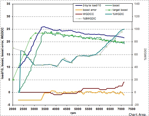

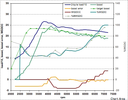

Below are results from this evenings runs. I'm now able to get almost the exact same boost in 2nd through 6th gear, and I'll get the same boost regardless of weather conditions, etc. Note that my boost curve looks almost like an MBC curve, but that is by design. Within the limits of what boost the turbo and WG can maintain, any boost curve is possible. An example of a more customized boost curve is Pd1's boost curve. Check it out below. It still needs some fine-tuning, but you can see that he's holding a nearly flat 27 psi of boost from 3500-5500 rpm, and then rapidly tapering down to about 21 psi by 6000 rpm.
2nd gear run
3rd gear run
4th gear run

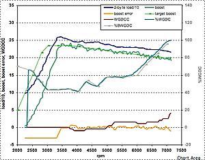

Pd1's boost curve
Attached Thumbnails how-to: ECU-based direct boost control-m55v14-bec-table.jpg   how-to: ECU-based direct boost control-evoscandatalog_2007.09.28_18.36.48_2nd.jpg   how-to: ECU-based direct boost control-evoscandatalog_2007.09.28_18.43.21_3rd.jpg   how-to: ECU-based direct boost control-evoscandatalog_2007.09.28_18.41.18_4th.jpg   how-to: ECU-based direct boost control-pd1-88590015-ecu-boost-run11.jpg
