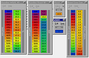

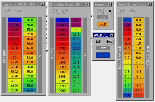

- I'm using a bleeder just before the BCS instead of a custom restrictor pills. A bleeder bleeds off boost pressure to atmosphere. The restrictor pill at the BCS is also deleted.
- My BWGDC values would not work well for a custom restrictor pill. The Boost Error Correction values should work for any setup though.

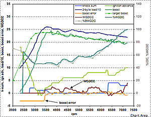

- A good starting point is to get a log with your current setup. After switching over to the direct boost control setup, leave your BWGDC tables unchanged, and use the boost values from your log as a starting point. From there, you can begin to fine-tune all the tables.
Thanks. Hope its useful. :-)
- The boost limit feature is unchanged and still active. It will key off of load just as it did before.
