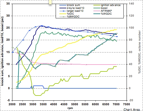

Well, the MAP seems to read a little lower than my OE gauge, but it's probably more accurate. I'm going to trust it since the atmosphere comparison was dead on. Here is a log of 4th gear ...
I pasted your log on top of one of my more recent 4th gear logs. Fairly similar load and boost. Main differences appear to be timing at low rpm and fueling at higher rpm.
Yeah, but I don't really know what I'm doing, so that's another difference.
I'm kinda jealous that you're spooling faster, but I honestly just guessed on my VVT map so it's not surprising. You also seem to have a little bit less boost taper. I'm running a bit leaner and running a little more timing.
Now, I did consider this a little conservative since I'm still on the stock cat and air filter. How do you think our numbers would compare?
I was at WOT by 2200 rpm. Looks like you didn't hit WOT until around 2600 rpm. I think that's why yours spooled a bit later.
You should be able to lessen the taper at high rpm with WGDC adjustment. The 3rd gear log below shows my current WGDC map. Notice how I increase the duty cycle as the rpms go up? This log shows the boost and load tapering, but I've done that on purpose. With a more aggressive WGDC map, I can hold a load of 240-245 out to 6000 rpm. However, the car was too prone to knock at high rpm, so I started pushing up load and boost at lower rpm, and taking a bit away at higher rpm.
I see that at higher rpm, your motor seems to hold the same load as mine using less boost. Do you have a TBE?
I was wondering the same thing last night about how the two cars would compare on a dyno. Does same load = same power? I don't know.
Attached Thumbnails log boost with JDM MAP sensor (updated instructions)-evoscandatalog_2007.05.15_19.09.24_3rd.jpg
