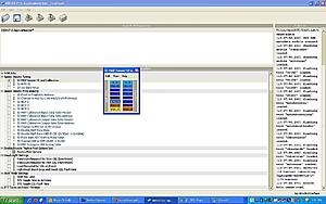

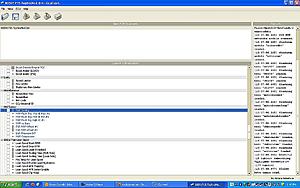

various pics for conversation on this topic.
