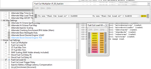

I might be having a brain fart, but I can't seem to find the boost limit table for Tephra V.7 rom 88590715.
Keep hitting boost cut right at 300 load, and can't remove it. I'm using a MBC.

This what you're looking for?

This one. This is a shot of a different ROM
Or if it's not there on this rom, how do I remove the boost limit for a MBC?

It is there in the rom, I posted the screenshot to show you where it is.

Fuel cut and boost limit are the same?

In this case at least, yes.
