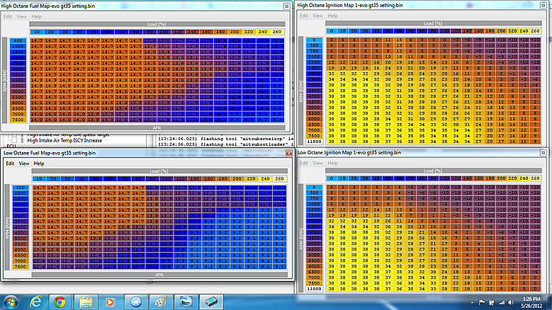

i just finished rescaling my load on my ecuflash ....at first they were stock from 0 to 260..now there from 0 to 300,i just wana post my maps up and let you guys see if there correct and i should flash it in my car.
i have posted both maps,plz take a look and see if i made any mistakes and need to change anything.
Attached Thumbnails ecuflash load rescale map..correct or not?-stock-evo-load-scale.png   ecuflash load rescale map..correct or not?-evo-load-rescale.png

in the ignition map , in some row there is too much difference, between value.
max 5* at cell.
max 5* at cell.
thanks,but can you elaborate a little more by what you mean?

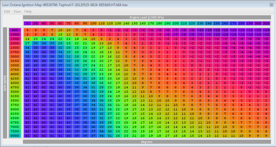

As you scan across the load columns from left to right, especially for your low oct ign map, there should be no more than 5* difference for a change of 20 load. For example you change from 26* to 16* at 3500 rpm when moving from 80 to 100 load. This is right in the spool transition to boost and is likely to give you some knock (=bad for your engine). Try smoothing the transition more to something like this.
You can also use the autosmoothing spreadsheet at:http://code.google.com/p/ecurom/sour...eadsheets?r=65to make this easier.
