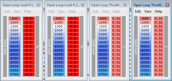

For example:
Attached Thumbnails How to set a Evo 6 ecu to full time Open Loop?-openloop.png

Thank you so much Dolphin...
So, i just set all the values as per yr pics right?
Old Jun 27, 2012 | 01:45 AM
dolphin888's Avatar
Posts: 208
From: Europe
Yes, but it may be, that you have % instead volts in TPS maps because of different scaling.
