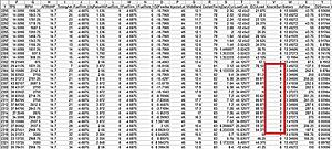

Hi Raptor,
attached is a sample of my log and can you kindly advise me which Cell Load im in on the Knocks stated.
Thanks

For low (< 160) loads you can use ECULoad. For higher ones though you'll want to setup 2-byte load.

What do you mean by "interpret"? Whatever number the load value is indicates which load column the ECU gets it's fueling and timing advance values from.
