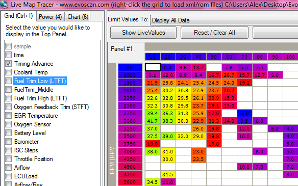

Smile Success?
So Apparently I just needed to log data for a longer period of time and ensure I didn't have the beta EcuFlash installed but instead the current non-beta version.
I'll continue to post what things I can find here and how I can eventually apply them to utilizing Tephra properly.

I can't figure out how to read the wrong code in spreadsheet
I'd like to be able to figure out how to interpret the code in that form. I figured out how to load the code into EvoScan and read there from the graphs.

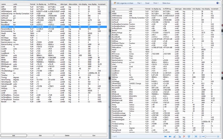

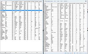

Examples
Here is the example logcfg.txt file I'm using. I'll eventually log different parameters and more of them after some time.
Also here is an example of some of the things you'll need to do converting to Tephra v7
This is the scaling parameters and the right is my current tune's scalings, the left is the Tephra v7 default scaling with several that I have added. You will need to add some parameters and modify current parameters to match your previous ones so that everything is scaled correctly. Also ensure your maps match that new scaling because some of the v7 maps and parameters use different scaling. Otherwise convert your parameters and maps to be scaled to match v7's scaling and ensure the values are converted to function properly once you have pushed the data over to the Tephra v7 rom.
