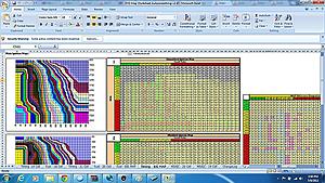

i downloaded the map smoothing tool. butdont know how to use it, didnnt come with any instructions, can anyone tell me how this works?

paste your map into table 2. the new smoothed table is table 1. the table to the right displays the changes made.
the third table can be used to monitor the changes/differences that have occured from the original map (not required).

thanks alot man, your a life saver
