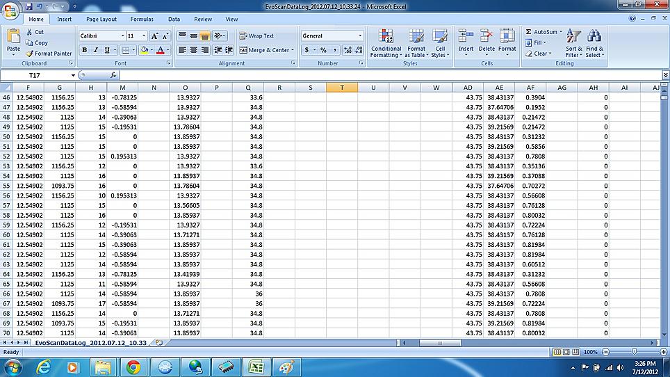

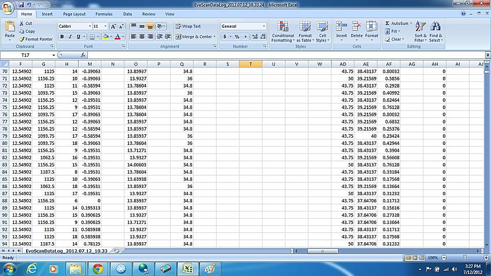

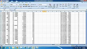

ok here are the pics of the data log..
tell me what do you see, do i need to replace the front o2 sensor?

You will have to log fuel trims and post a file where we can see what is going on... that screenshot did not show fuel trims...

To me, it looks like your front o2 is on it's way out. Your timing at idle hits a low of 6* and a high of 18* with your o2 voltage going from .15xx to .8xxx. Does it have a rougher idle than usual, or sound like it lopes a little more than usual with the cams?
My car doesn't have cams but, if you heard it at idle and didn't know the car, you'd think it did have cams. I'll be replacing my o2 this weekend, I'll post a log of my idle so you can compare tonight.
