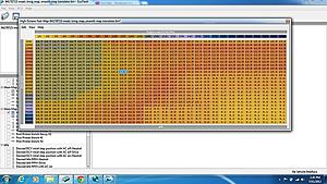

this is my current fuel map, can you guys plz point out the areas where i need to tune the fuel map, espically the cruise areas....
before my cruise area was 15.5 afr, yesterday it was in the 14.2 afr range, do i need to lean out the fuel map in those areas to bring it back to 15.5?
and also i saw 4-5 counts of knock in my logs at 2800-5500 rpm range, is it because im running rich in those areas?

Old Jul 11, 2012 | 02:30 AM
todd6027's Avatar
Posts: 1,861
Likes: 13
From: Ireland
save yourself a headache and run closed loop

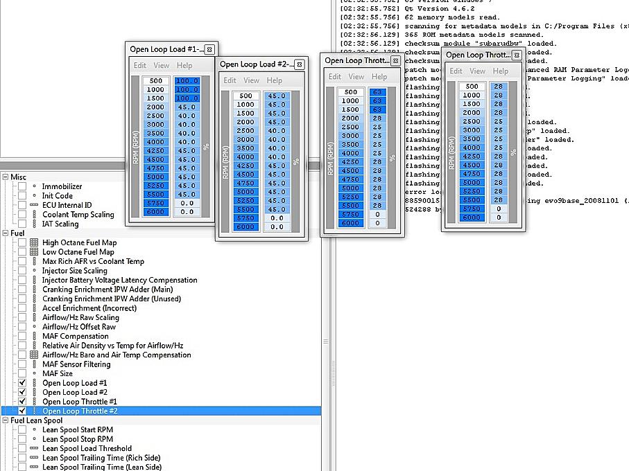

if your running closed loop and your idle afrs are near 17 you probably have a bad front o2 sensor. the ecu has a lot of leeway and can add or remove a lot of fuel when in closed loop (+-25% something like that) so if your going lean in closed loop you've got an issue. Because the fueling is ok in open loop I would say consider replacing your front o2
I'm not sure why you wouldn't have any problems at cruise but its possible if/when you had the car tuned they set the open/closed loop switch over threshold very low so its really only running closed loop at idle. You would have to pull your rom and look at it to see if that is the case.
The image below shows the tables you are looking for although they can vary in location depending on if your running tephra or not. You can see in the picture I provided that this rom will switch to open loop at 45 load for the most part (or 25% throttle whichever comes first) 45 load is really just above idle load so during cruise this rom is in open loop almost all the time. See if your load numbers are similar or if your throttle numbers are fairly low (like 20% or something), my evo idles at about 13% throttle I think to give you a reference.
It wouldn't hurt to post up a list of your mods also. As far as tuning the car in open loop, it sounds like your just having idle issues if your fueling is fine during cruise and wot. I run my car in open loop all the time so I can have a leaner idle and cruise than 14.7.

okay here are my mods...
gsc s2 cams
aem wideband
walboro 255 lph pump
catless exhaust
gt35r
my idle throttle position is 12.5%
and the front o2 sensor is the one that plugs into the exhaust manifold right?
and here is my open loop load tables..
