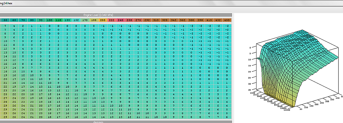

So, I've been spending several hours per night tuning my car, and I've got it dialed in really well for normal driving. I can't seem to get the car to not knock though once it hits full boost and starts climbing RPMs. I've tried adding more timing all the way up to 11* at redline, and as little as 2* (which I know would be too little), and I CAN'T clear up the knock no matter what I do.
I attached my ROM, I'm running 2D SD with an OMNI4-Bar, GM AIT, Spool AIT to MAF harness, and I'm on 93oct.

Your timing map load scale does not match the load shown in your logs. Youre in desperate need to rescale the timing and fuel map load axis. Also your timing map needs a lot of smoothing. Dont try to hit your low timing for peak load as soon, instead it should be a slow taper to the point of low timing for peak load.
your load axis only goes to 350 where as youre hitting 400+ load..
the KPA on the load doesnt mean the same KPA that is in your VE tables on the KPA side, that actually references the load from the listed KPA value. I dont understand the non linearization in that respect.
If i were you, I would tune wastegate pressure and increment from there

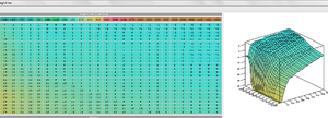

timing map should appear to decrease with boost and increase with rpm.
follow this trend, youll Find the sweet spot .. I'm still looking myself
