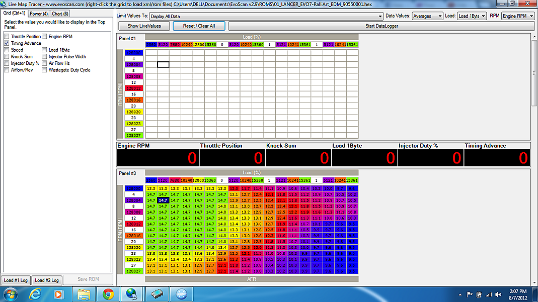

hi how do i use map tracer, when i open evoscan 2.9 and go to graphs and map tracer, it opens up but shows out of place RPM and LOAD numbers, and when i load my map it doesnt show up on map tracer, what could be wrong?
here is the picture of the load and rpm numbers

You need to make a copy of your ROM file wherever you are keeping it and paste it into My Documents->EvoScan->ROMS folder and ...->rommedata->mitsubishi->evo folder, then reload evoscan and select ROM file from ...->rommedata->mitsubishi->evo folder.
I don't understand why this bug isn't fixed yet, as well as other bugs I am getting frequently...

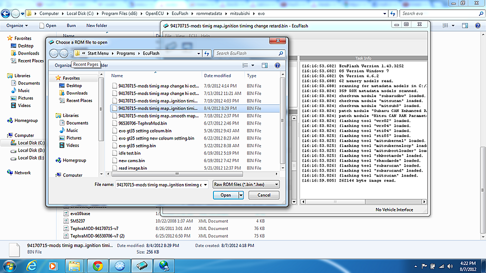

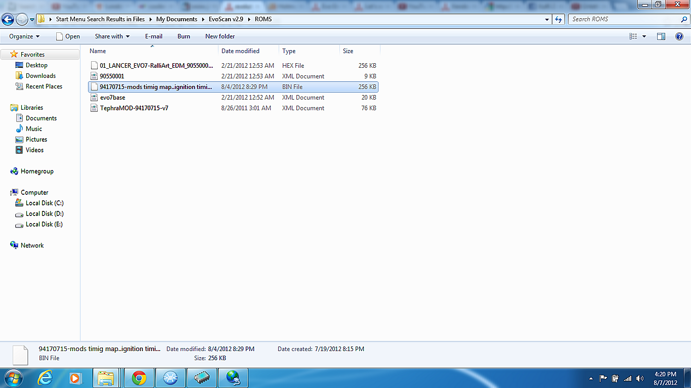

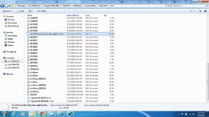

ok i'll post up a few more pics so you can guide me step by step,
first i opened ecuflash>folder copied my rom, then i pasted that in My Documents->EvoScan->ROMS folder and then >rommedata->mitsubishi->evo folder
when i reload evoscan, there is no option to select my new rom?

EvoScan uses the ECUFlash rommetadata folder to get the correct XMLs to use for the program. what you need to do in the map tracer window is right click 'panel #3'. Click the first option 'Load ROM...'. find and open your ROM. EvoScan should automatically load the correct XMLs and maps as per the ROM file.
