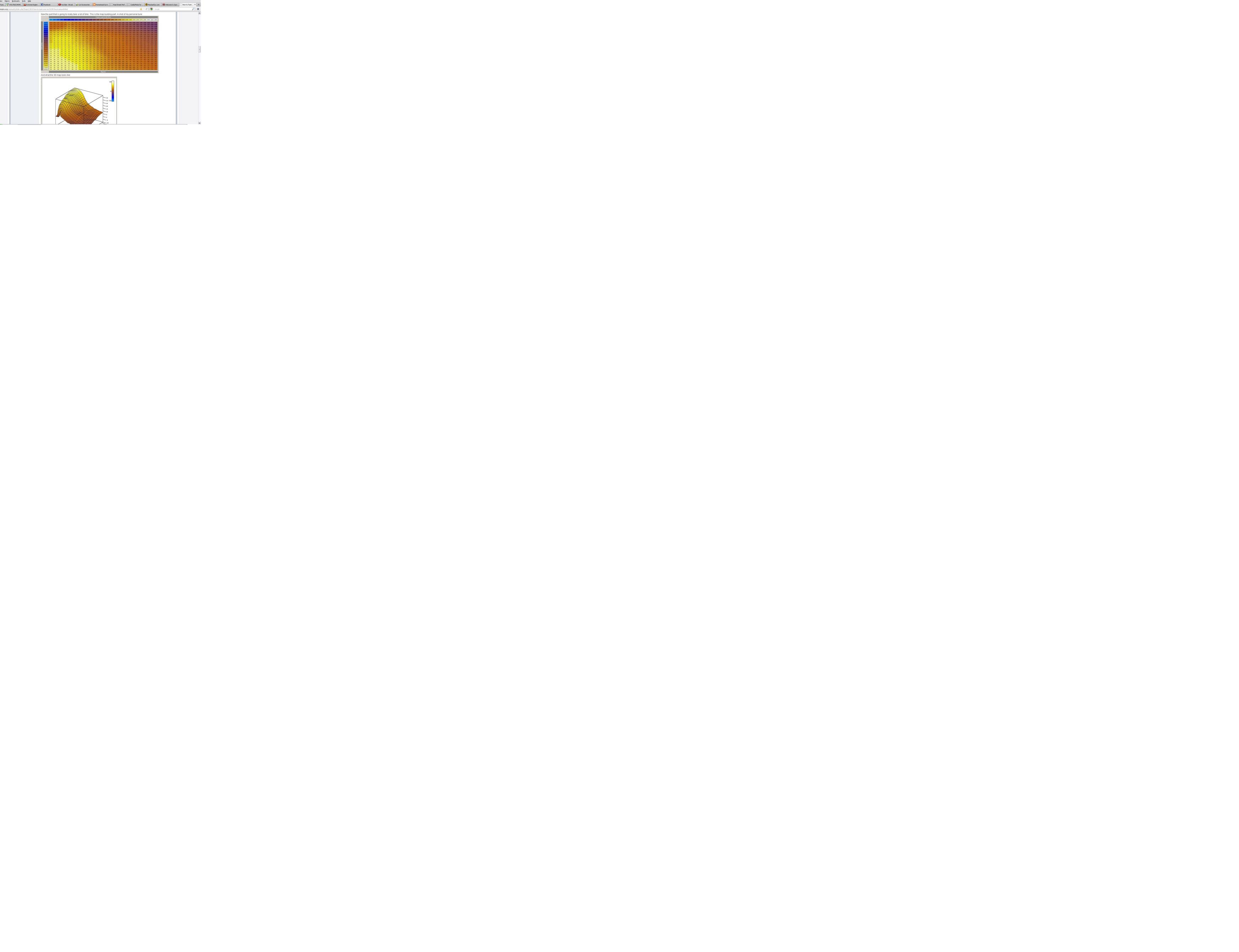

My Current Tune Map - Pls Advise

Originally Posted by jameswwt
Hi Boosted Tuning,
i thought the LS is disable since the start is at 2500 & stop is at 7500.
1) How do i disable it?
2) Should i scale the MAF smoothing first follow by scaling and do i need to retune the fuel map after that?
3) How do i make it full time open loop?
Thanks
1- Yeah, set both the start and stop to same RPM ie 1500 or 2500.
Also, another way to turn it of is to turn bit 0 in ECU Periphery1 (FBA) Bits, from 1 to 0.
2 - You shouldn't touch MAF smoothing. Only touch MAF scaling and/or MAF comp to scale the MAF.
3 - You should prob leave it in closed loop, IMO.

I think everyone's already said this... but do you really want to go through all the hard work of modding and tuning your car... and then half *** it when it comes to the timing? Block timing sucks...
Timing should be smooth, not with a block of fours. Think of it as a game... you want to have everything make a smooth transition. Check out some other timing maps as examples!
Thank you Jay...
But will it more benefit to disable Lean Spool?

Guys ive tried adding load cell on Y & X axis but no matter how i smoothen the map (timing or fuel map) the cell numbers will kept adjusting by itself.
Exmp : when i adjust the high octane maps (timing & fuel) the low octane maps will runs even i copy the entire high octane maps to the low octane maps.
After copy, the high octane maps will adjust by it self again.
Here is 1 example Map that i which to have its add load cell.
(http://evoempire.org/community/index...yang-articles/)
Pls refer to it timing map
Pls advise on how to adjust the maps correctly
Thanks
