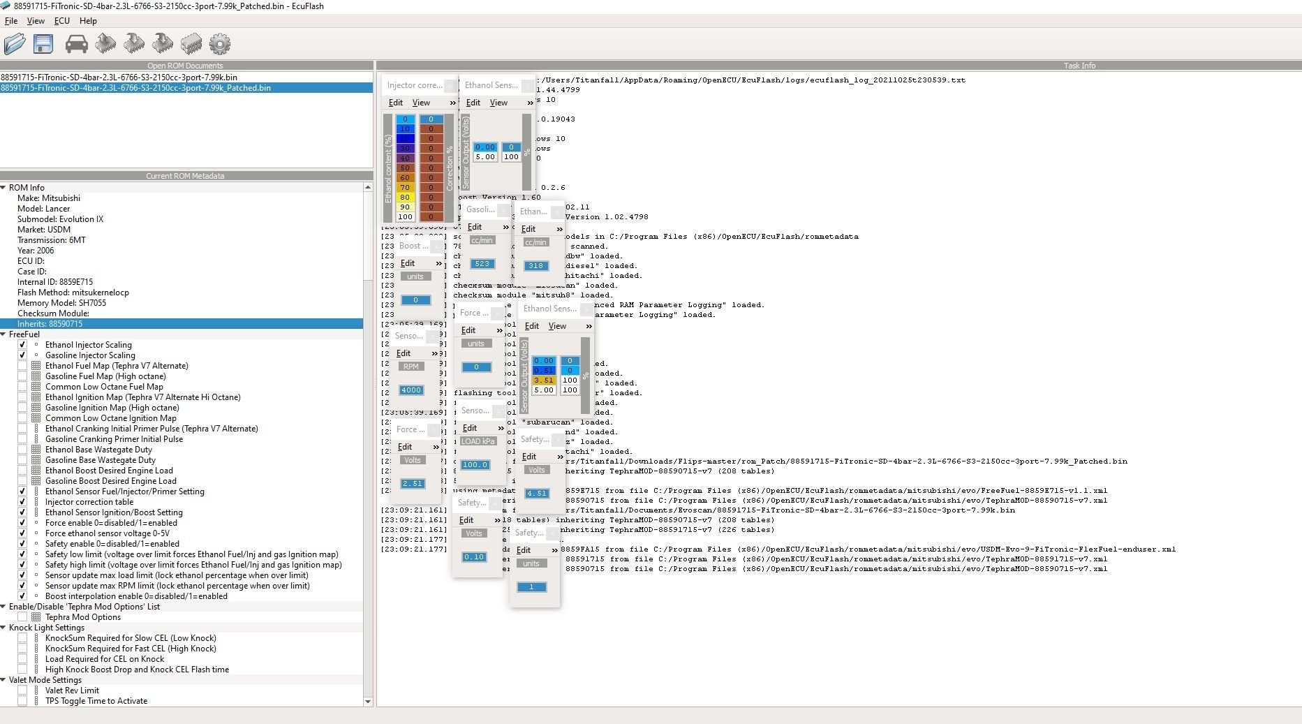

Originally Posted by orion4096
I looked through Tephra 88591715 and the FF code doesn't seem to conflict with any of the speed density changes. The attached zip has an ips (instead of bps) patch file which will apply to any ROM without a CRC check. See the included readme for how to patch.
  • The included FF XML uses 88590715 as a base. You can modify the following line to use 88591715 as a base instead. I guess a new FF ROM ID could be used like 8859F715, but I kept just the single ROM ID like the original FF author. The XML has the FF stuff in a new section.
    • <include>TephraMOD-88590715-v7</include> change to <include>TephraMOD-88591715-v7</include>
  • The FF patch changes injector scalings (see https://www.evolutionm.net/forums/ec...l#post10405712) which you might not expect if you apply it to a modified/tuned Tephra ROM.
I have an extra (2006 Lancer AT) ECU that should help with testing. Still need to figure out an easy way to get the code into ignition on/engine running state without having to drive a lot more pins.

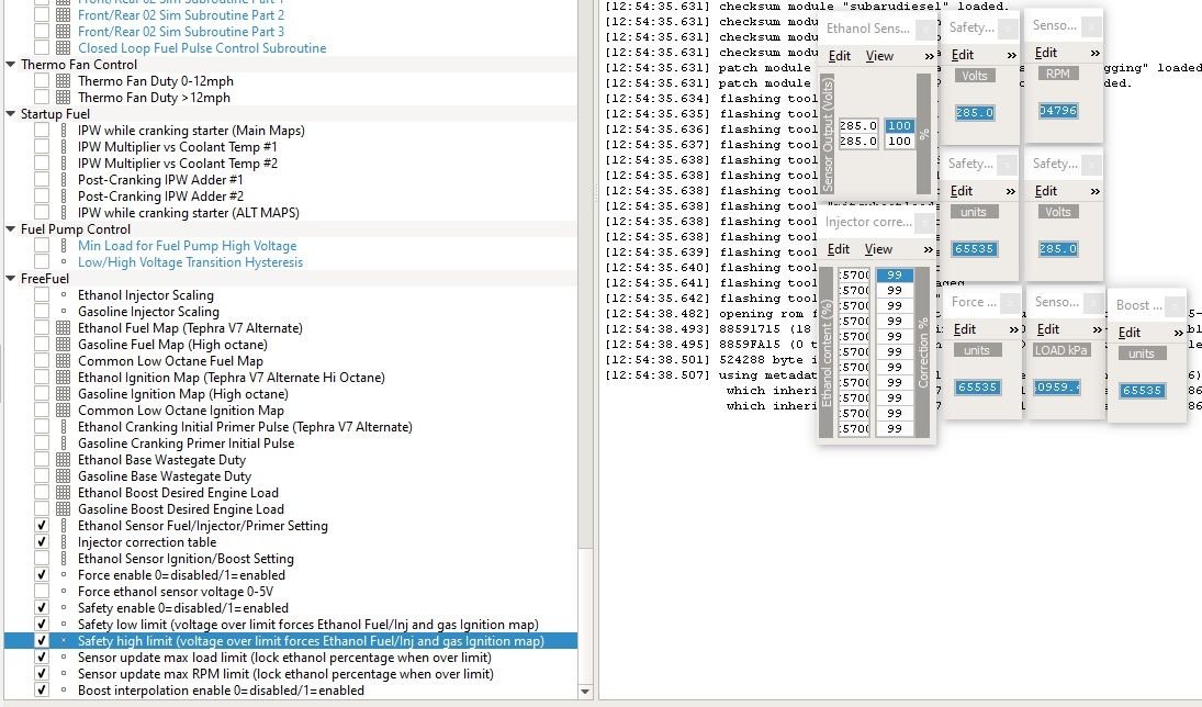

I have a few tables not properly defined.
Everything else seems to be defined and working.
Most importantly was defining the injector scaling. Those tables were hidden, so it was rather difficult to dial in the injectors.
The Ethanol sensor % tables aren't defined though.

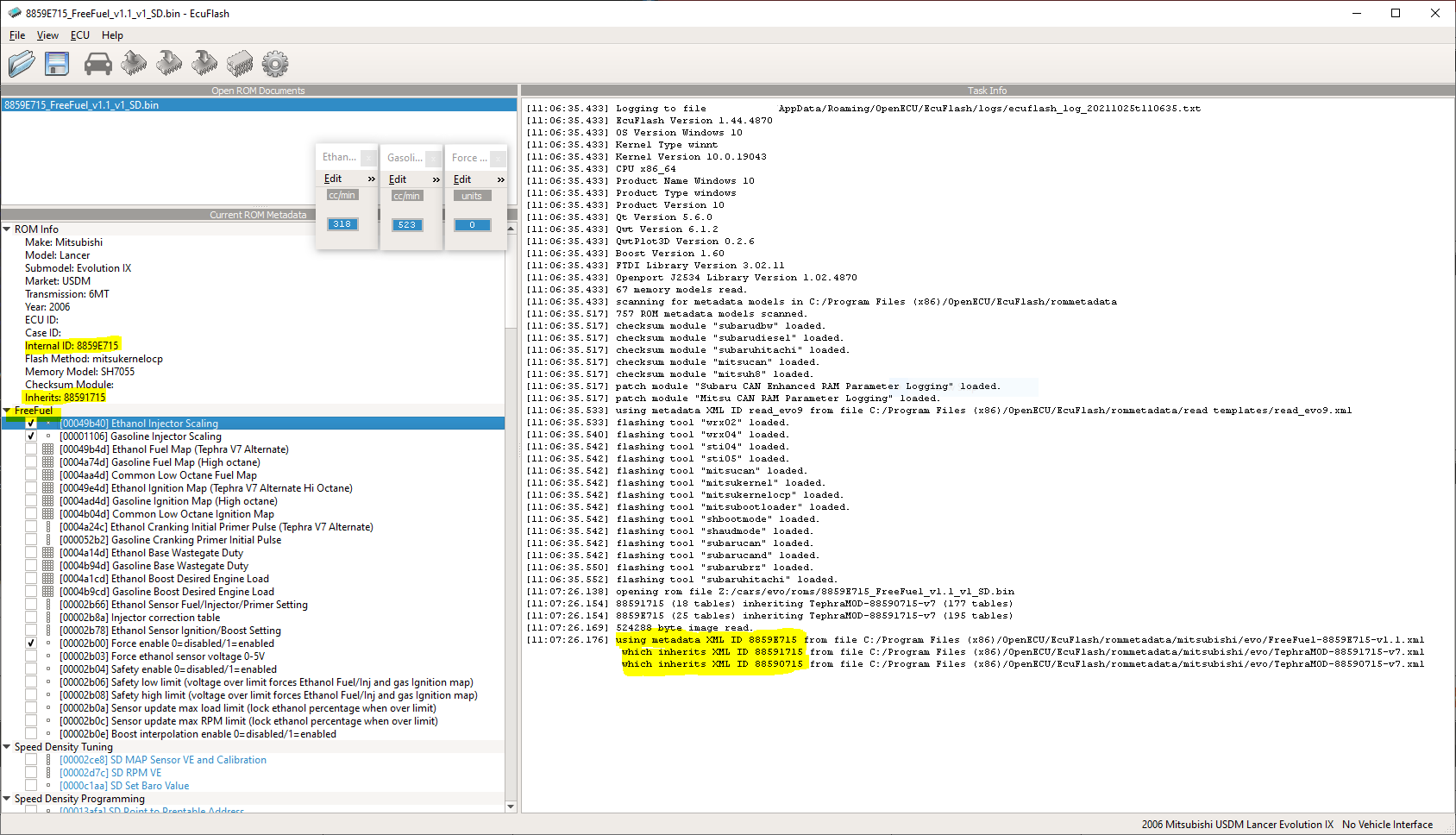

The XML file you attached is still looking for ROM ID 88591715. The FF IPS patch changes the ROM ID to 8859E715. So if this was the only XML file change that was made in your OpenECU metadata directory for FF then the opened file is probably not patched with the IPS which is why the values in the tables are not correct. See the readme for instructions on how to patch it. You'll want to:
- Patch your ROM with IPS file. It will change the ROM ID to 8859E715. Use the program floating IPS as described in the readme. Make sure to patch a Tephra 8859 .bin or .hex ROM file. Make sure to save the patched file with a .bin or .hex extension so EcuFlash can see it.
- Copy the XML file included in your zip to your EcuFlash evo metadata directory. Mine is at C:\Program Files (x86)\OpenECU\EcuFlash\rommetadata\mitsubishi\evo\ FreeFuel-8859E715-v1.1.xml. If you are not using 88590715 (MAF) as a base then open this xml file and change the inherit line to the correct base ROM ID. For SD it will need to change to 88591715.
- Read through the posts in this thread that explain how FF works, what assumptions it makes, and how to tune it. AST is the author of the FF code.
- Open up the patched ROM in EcuFlash. The messages should look like the picture below.
- Go through every component of your tune, adjust it where necessary, and make sure it matches your expectations on how to setup the FF changes. Talk to your tuner and see if they are willing to help if your not sure how to do this.

Well it seems like I have patched it correctly.
Btw my car is already tuned on a flex fuel rom 88591715 ... I am just trying to define the tables correctly.
Does the patch change the values? Injector scaling is different now.
Tables seem to show correct values...
