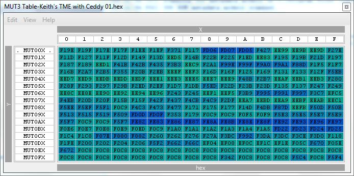

Yes I had read that thread, created my own file and just wanted to see if anybody would comment on my config file really.
Also I have noticed that my 1byteload and 2byteload values are way off, how do I find out if I need to make any changes to my MUT table for these values for the TME ecu? I am using Ceddy's xml file. I have read a few threads on here where people have been told to check that MUT41?? has the correct value.

what do you have for mut00 and mut01 ,,, rom id ???
rom id 25570100
Model H8539FA
I have attached a screen shot of my MUT table

Old Nov 3, 2012 | 01:21 PM
todd6027's Avatar
Posts: 1,861
Likes: 13
From: Ireland
that looks ok did you download ceddy xml for evoscan send me your e mail address il send it over

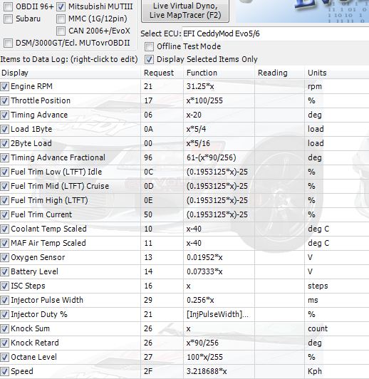

Hi yes I downloaded the full zip file, and renamed my old xml before copying the Ceddy modified xml over to EcuFlash. I also an running Evoscan 2.9 which has the xml pre-loaded for Ceddy's xml file.
I can upload a log file and my version of the xml if you like? Only just starting out with this so may not have everything sorted yet as I am just logging and making small changes at the moment. Running on 99 RON fuel here in the UK.
Keith

in evoscan device set up top left are you using mitsubishi mut III
1 byte is request mut41 and function 1.2*x
2 byte mut 00 0.31258*

Attached are my files:
Looks like my evoscan stuff is incorrect though?

Old Nov 3, 2012 | 02:30 PM
todd6027's Avatar
Posts: 1,861
Likes: 13
From: Ireland
looks a bit odd alright il check a ceddy mod evo 6 with evoscan 2.9 on monday see if it logs load correctly
