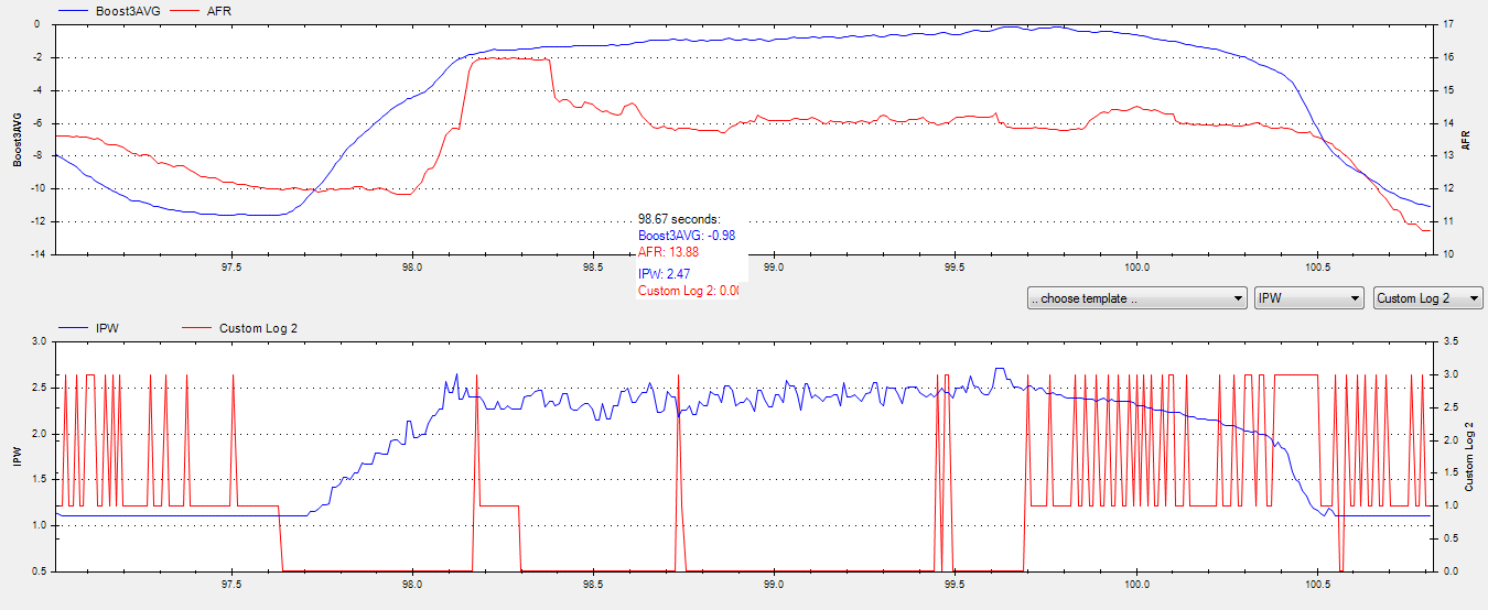

Here is a good example of the tps decreasing thing..
Check the right hand side, see how the ipw "smooths" out, when custom_log_2 goes spastic.. thats basically detecting tps decreasing.
in addition to the 5% thing, these maps (post #1):
Load Increase/Decrease threshold
Load Increase/Decrease divider (ie 1 is biggest)
Load Increase/Decrease multiplier (ie 1 is smallest) #1
Load Increase/Decrease multiplier (ie 1 is smallest) #2
control how much load is added/removed in steady state, steady state DOESN'T apply when TPS is decreasing, only when it's increasing or not doing either...
Formula is something like Final Load = New Load + ((New Load - Old Load) * (multiplier / divider) / 50)..
It also doesn't help that I am running the Direct MAP patch (so my MAP signal isn't being averaged at all)
All in all, the stock ECU is a bit retarded when it comes to calculating load...
