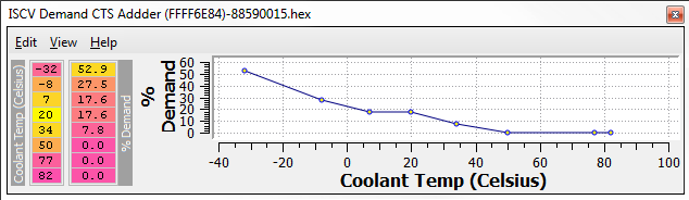

I have been over and over this trying to find a solution with the help from you guys. I did find something else that might be the forest for the trees thing.
First I would like to see if anyone else could provide USDM MR 9 values for the table noted above for comparison. All my stock reference ROMs are different that Domyz provides. ISCV Demand CTS Addder (FFFF6E84)
Now I also found that my Idle Stepper Lookup Table I currently have is different than my reference ROM. Would this kind of setting exhibit itself in warm start issues. Seems like it to me, but I wanted feedback before I go changing it back.
I may have futz'd with this when I was aimlessly fighting a TB leakage problem, but I can't recall what I did and didn't do.

Yeah just put this column back to stock (like the 34C column). Those numbers are illogical and will mess the iscv behavior.
This is the stock value:
