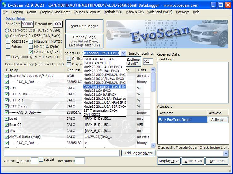

I've written a ROM patch that allows you to log 30+ data items at a usable rate.
You can log directly via EVOSCAN - Version 2.9 Revision 0023 (or later).
BIG thanks to:
  • Hamish: for developing the EvoScan support for RAX Fast Logging.
  • Golden: for his invaluable expertise on the subject of ECU variables.
  • Those ECU guru types who ferreted out our ECU functionality in the first place. You know who you are.
GET RAX PATCH HERE - Now includes RAX Fast Logging!
The Patch
This uses a "packaged data" approach. On a patched ROM, the new RAX Fast Logging code will bundle up some 32 discrete data items into a 32-byte block of memory. That data can then be bulk-read by a compatible client.
This gets you faster logging, because one "read" operation delivers multiple items.
The Logging Client
EvoScan 2.9.0023 has been given the ability to extract bit-wise data from larger blocks. It requests 4 bytes at a time, then extracts 4 items from each package.
This version of EvoScan now comes with a new “RAX Fast Logging” selection, chosen via the “Select ECU” dropdown box. You simply select it… and start logging from any RAX-enabled ROM.
Logging Speed
RAX Fast Logging + EvoScan will boost logging speed by a factor of 4.

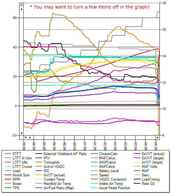

To further optimise things, the default EvoScan configuration for RAX Fast Logging has some "Priority" tweaks, designed to prioritise some data items over others. With this default setup, you should see up to 20 lines of data per second. Note that some data items will only be updated every 2 or 3 lines.
If you strip out the "Priority" optimisations and just log every item on every cycle, you will still see 12-13 lines of data per second.
The Data
All of the usual suspects should be covered. You can log pretty much everything you need, all at once, right out of the box... at 20 lines per second.
There really is quite a lot of data...
There are also some extra items you won't have seen before, to do with load tuning. Those items came from an investigation into Load Ramp Rate. Very useful stuff.
When you download the latest RAX Patch fileset, you'll find that it comes with a comprehensive pdf instruction document. It lists all the logging items supported, value ranges, resolution limits, etc.
One of the nice things about RAX Fast Logging is that it does away with the need to know ROM-specific addressing for the supported data items. The patch collects everything internally, places it in the SAME memory position, in the SAME format... across all supported ROMs.
You can obviously revise EvoScan's scalings and data to suit your particular requirements. For example...
  • If you read wideband data via rear O2 sensor ECU input, you'll want to plug in the appropriate formula to convert to AFR. You'll also want to align GaugeMin/GaugeMax/ChartMin/ChartMax with "Air/Fuel Ratio (Map)" to get the secondary graphing scale working.
  • If you use "Metric Units" mode but prefer PSI to kPa for Baro/MAP/Boost, just delete the stuff in MetricEval/MetricUnits for those items. It'll revert to PSI.
One extra thing worth noting: When you are looking at RPM, LoadTiming, TimingAdv and KnockSum, you're looking at a snapshot of a single ECU "cycle". All four of those items are collected in one go, and requested as one. RPM/LoadTiming should give you the EXACT spark table reference used at that instant, the TimingAdv is the actual timing being used at that instant, and KnockSum is... well, you get the idea. This helps a lot when interpreting the data!

Attached Thumbnails RAX Fast Logging-2012.11.29_evoscan1.jpg   RAX Fast Logging-2012.11.29_evoscan2.png

Awesome work Richard, well done, I tried out your amazing RAX EVOX fast logging, and with EvoScan and by prioritising some dataitems, I can consistently get 20 lines with 35 items = 700 samples per second.
