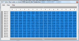

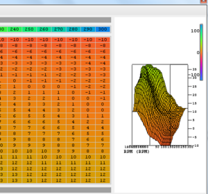

If you over wrote your existing install it will be in one of the "backup001" etc folders.
My Mut table looks fine, and 3d works for me. Im not sure what the problem is with it on notebooks though. I always just have to drag the table over to view it. But it displays and pivots properly.
Attached Thumbnails New EcuFlash 1.44 problems-3d.png   New EcuFlash 1.44 problems-mut.png
