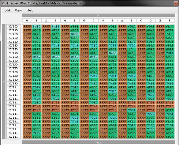

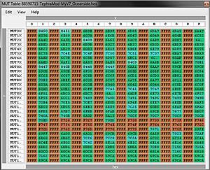

Originally Posted by 92LaserRs
If you over wrote your existing install it will be in one of the "backup001" etc folders.
My Mut table looks fine, and 3d works for me. Im not sure what the problem is with it on notebooks though. I always just have to drag the table over to view it. But it displays and pivots properly.
wtf. mine looked nothing like that..
also what are the benefits of upgrading to this??? whats the + ???

http://evoecu.logic.net/wiki/Add_MUT_Table_To_EcuFlash
Someone can correct me if I am wrong but wouldn't setting your mut tables with the second xml code on this page correctly show the 3d tables on notebooks? If you are using the tables with all the f's in it that would be causing the issue correct?
