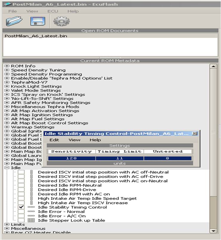

Hello Jamie & All,
Thanks for the great write up!
Have a couple of questions that I hope someone could help me with;
1)When modifying an xml, where do I copy paste these definitions into? My ROM ID is 94171715, do I modify the associated xml in order to show your ISCV tables? This is the xml I am using among the other bundle downloaded form the Tephra thread (TephraMOD-94171715-v7.xml)
a.Also, where in the xml should the definitions be pasted into? Bottom, middle …etc
b.FYI lowest battery voltage experienced during the drop was ~11.9V and coolant was ~181F
c. I tried copying the definitions into the 94171715 xml but I wasn't able to see the tables.
2)I am running an engine die out or near stall events on my current setup and I was wondering if you were ever able to find the calibrations that locks the timing to 5*. In the data below you can see the engine is struggling to recover while the timming is locked.
Mods: stock 2.0l, hta86, FIC 1450, GSC S3, AMS F1, E85
Thanks in Advance!
Here is how my ISCV sections looks like.
This is the idle error offset I played with in anticipation to save the maneuver. I also tried messing with the timing offset based on rpm error but that didn't seem to make a difference.

In the example shown above, the spark advance is locked to 5*BTDC because the engine speed did drop below 500rpm (475rpm or something like that is the threshold) and the ECU thinks its in cranking mode again.
Look in your xml in Idle section, find the table with address 4324.
This is the "Idle-up Position Decay Time (After Starting)" table. Make the times a lot longer so it will keep the ISCV open.
That should help, if not fix the problem.
