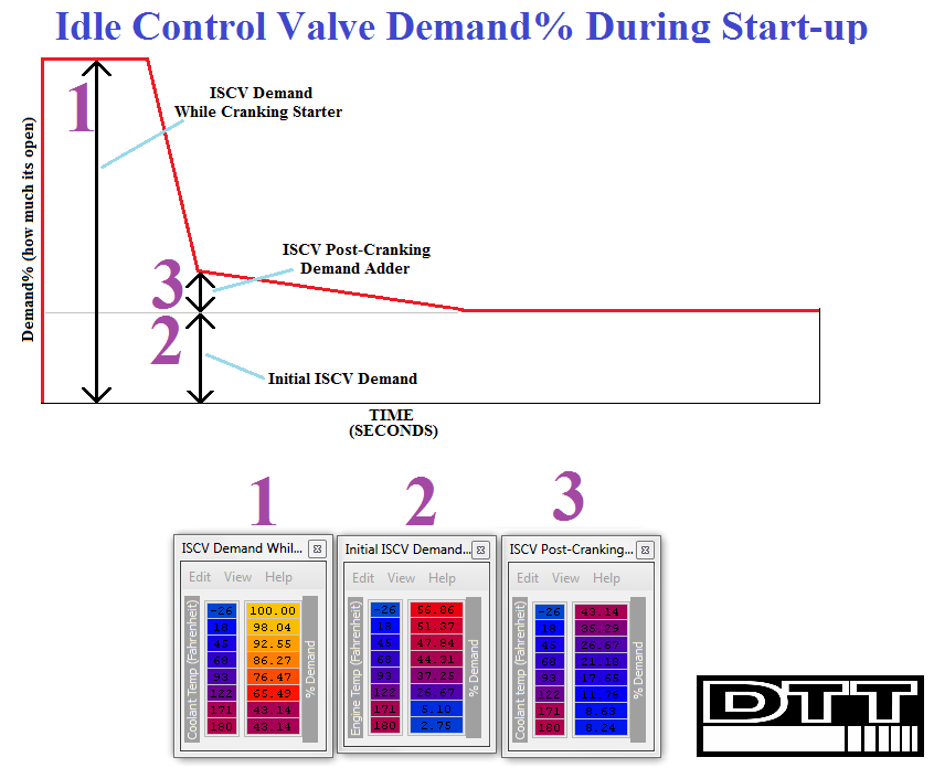

The airflow is controlled via the Idle-Control valve in almost the same manner as the fuel during start-up.
ISCV Demand While Cranking Starter
This works just like the fuel, it opens the idle control valve to almost the fully open position while cranking the starter. This allows the cylinders to ingest as much air as possible at first.
Initial ISCV Demand (AC off-Neutral)
This is the base ISCV demand that all trims and compensation tables start from. Some trims are adders, some are subtractors. Regardless, this is the primary table that everything works off of.
ISCV Post-Cranking Demand Adder
Just after the engine starts and the [ISCV Demand While Cranking the Starter] table disengages, the idle-control valve will drastically start closing to prevent the engine from revving too high. The engine is still stabilizing itself so the idle-control valve cannot just drop to the [ISCV Initial Demand] setting without suffocating the engine and stalling. This table adds more Demand just after the starter stops cranking to prevent this, while slowly tapering back down to the [Initial ISCV Demand] to give the engine time to stabilize.

So now that you understand the 2 sets of 3 primary tables that help with Start-ups I can tell the easiest way to decide which tables you need to adjust.
  • If the car won't start at all, adjust the tables labeled #1 for fuel and ISCV.
  • If the car starts but then runs really rough or dies within the first few seconds, adjust the #2 tables.
  • If the car starts, runs for a few seconds really well then begins to run rough or stall, adjust the #3 tables.
