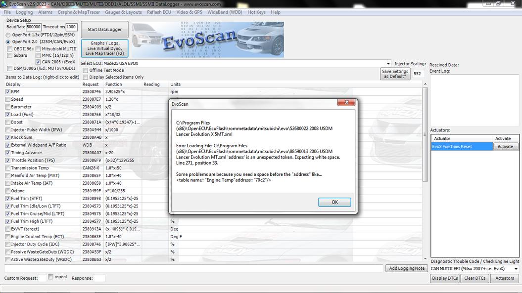

Need some help with this please. Problem started with updated ecu flash.
Newest versions of both evo scan and ecu flash.
Tried several things but I could not fix

EvoScan must use EcuFlash XMLs for its map-tracing functions... and it doesn't like something in those XMLs.
If you're not actively using those particular ROM ID XMLs, maybe rename them to ".xml_old" or something.
If you are using them, then you could try fixing up the XML definitions - to fix those errors. XML is a very tight spec, but some parsers are slack. I reckon EvoScan's parser dislikes something in the "new" EcuFlash's XML fileset.

In addition to what Richard has mentioned, EvoScan will also parse all other XML files and if it finds an error in any of them, (even though it's relating to other ECU ID) it may not work properly.
Here's what you can do, created a new folder and place ONLY the ECU ROM file and it's corresponding XML definition file in it and it should open up in EvoScan Map Tracing screen without any problems.

Okay got it to work with my backup XML files. Was just trying to get it to work with the new stuff.
