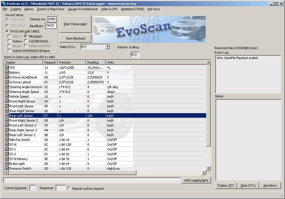

Today I've fixed AYC (after almost 1 year of owning it).
It's wasn't working because some of previous owner was removed ABS ECU. After connecting speed sensors directly to AYC ECU by installing jumpers at ABS ECU connectors it's now working.
So... Now the question. Why AYC showing "Rear-Left Sensor" value 184 km/h? Like it's max speed.
And it decreases at driving forward. In log you can see how it goes. But "Rear-Left Sensor 2" and others show right values.
What is it and why?
P.S.: remembered that before repair is also shown this value.
What is it and why?
