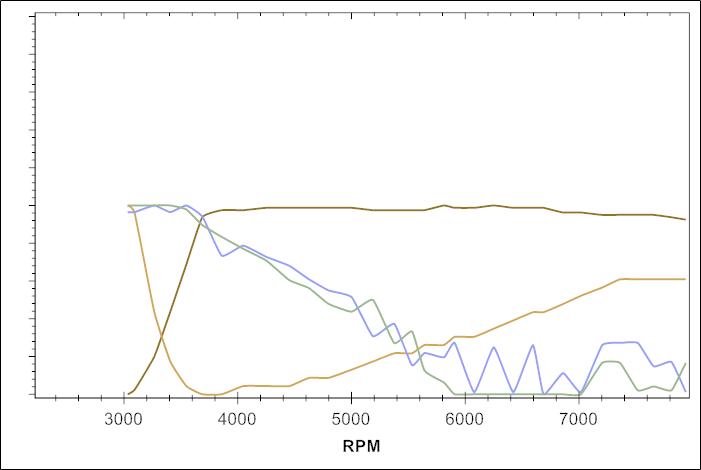

Mivec log VS Mivec Map : oscillating actual
anyone else experience this?

the flat line at the bottom is zero mivec, correct? my logs of actual mivec that i obtained years ago showed actual mivec sticking pretty close to target:
https://www.evolutionm.net/forums/ec...y-notes-2.html
yours looks reasonably close except at what i'm guessing is zero mivec. the spikes in your log could be due to being near a high byte transition as i mentioned in my thread.

Sorry didn't notice there was no key. Here's boost ign timing and mivec map / mivec logged . il. Ill review that thread
Not exactly zero at bottom johnbradley's posted map maintains some adv

thx mrfred that thread answered some things on my mind
