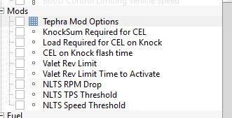

I tried to log my car with evoscan 2.9 but the fuel trims are always "0" .
I've read in some threads that if the rear O2 is disabled then the LTFT won't work.
I checked the periphery0 (FAA) bit 1 is "0".
Please advise of a solution in order to be able to log the fuel trims without loosing the knock cel (return to the original Rom).

change it to 1, change the tephra option to simulate rear o2.
then, make sure you are not in closed loop all the time. (open loop load tables should look normal)

change the tephra option to simulate rear o2 (can't find it )
then, make sure you are not in closed loop all the time. (open loop load tables should look normal) --- do you mean to alter the tables in "open loop disable below" and "open loop enable above" ??

v2 does not have the "Simulate Rear o2" patch.
