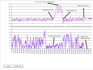

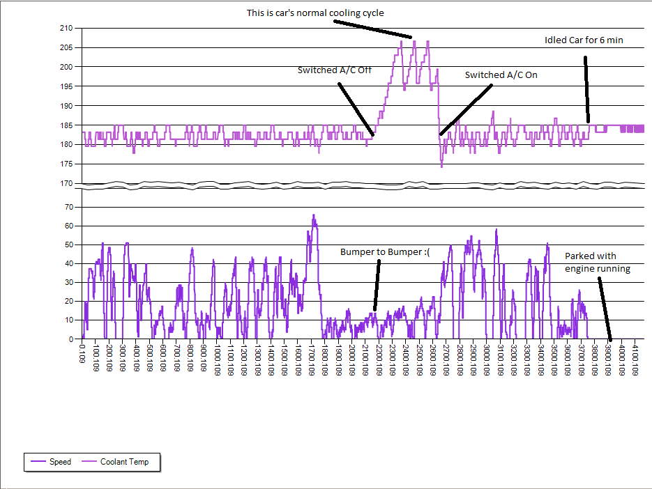

Car runs fine. I just have a touch of OCD. I daily drive and deal with lots of traffic. I found a long time ago from experimentation and logging that if I switch on A/C controls whenever I'm stuck in traffic, both fans kick on high speed and the car maintains consistent temps of around 192 F. Well then, how about I additionally pulled my A/C compressor clutch fuse to prevent A/C compressor clutch engagement. No compressor sapping engine power and avoid introducing additional heat from physics of refrigerant condensation. From this, I got even lower temps -- steady 185 F. One side-effect though is with A/C is set to "on" ECU runs engine in idle up mode, something I'd like to avoid. BTW, I'm not concerned with how this affects fan life -- they're pretty cheap.
Here's a plot from a data collection displaying coolant temp along with vehicle speed. I want to get these results using the tables instead of the ghetto A/C hack and deal with all the silliness that comes with it.
I know the good engineers at Mitsu say it's OK to let the car heat cycle like that, but if you can get these demonstrated consistent temps, then why not explore? Also, this could be a good way to cool down in the paddocks after track sessions.
