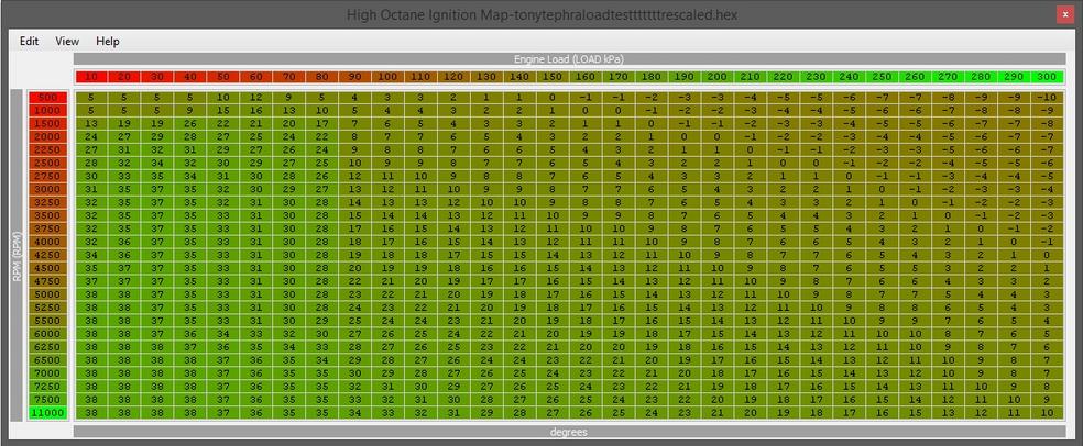

So I'm running tephra7. Max load I've hit is about 280. I'm not hitting anywhere close to 350 load so I decided to rescale my tables to max 300. Therefore I can have a smoother transition between cells. That is better correct?
Just want to see what you guys think. If I did something wrong...Thanks guys.

What I did was set the last column to 300 and copied the values from my old map to the new one. Then interpolated horizontally and vertically from 100 load to 300.

Yes that's fine. Don't forget to also rescale both fuel and timing maps, as well as low octane, launch and alt maps if you use them.

It should help be smoother. Make sure you change all associated maps, too. High/Low Octane Fuel and Ignition all need to be rescaled together.

Thank you guys for the quick response. I just finished my fuel. Now on to the low octane ones.
