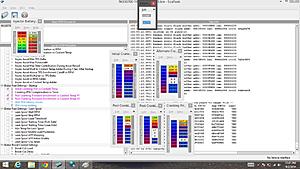

I've been chasing my tail on this one. I'm having warm start issues and the car will randomly stall. There was an instance where the car was idling at max rich on the wideband so I shut it off and restarted and it started to idle normally around 14.7.

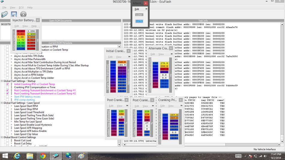

attached are my scaling and latencies. Also cranking vs coolant temp, alternate cranking ipw, post cranking enrich...
Won't start unless I hold throttle down. Tried decreasing cranking ipw in the warmer temps, nothing.
Trims are low: -0.7 and mid: -4.6.
o2 feedback hangs around the trims but randomly will jump to around +25...

EDIT: Upon looking at logs I noticed battery level never goes above 13.95v but the turbo timer voltage reads 14.2 and I was going off that. Would it be advised to go back and adjust latencies under the 14v area?
Quite frustrating as I was able to scale fic 1450's in 30 minutes but these are being a PITA or am I missing something...

I question your O2 sensor if your LTFT are what they are and then it spikes to +25%, general indicator of it being bad. I have had 1650 cars that start perfect and then others that require a little foot action to get them to work. I would add some cranking enrichment back in (1-2usec) and then drop 9v latency by 0.250 to start.

Okay I'll keep trying then. Decreasing 9v latency from 1.800 to 1.560 as ecuflash would't take 1.55. Also bumped alt cranking primer initial pulse from 0 to 1ms at 68* and up. Hopefully this gets it closer!
