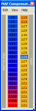

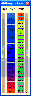

I am using a 2g MAF so I changed the MAF size to 286.0 and the MAF Scaling to a suggested scaling. I used suggested injector scaling and latencies for the 650s and started by dialing in WOT by disabling lean spool and setting all values above 100 load to 10.5. I was able to get WOT afrs to match no problem at an injector scaling of 609.
Next I did cruise trims (ltft-mid) by driving around (no boost) and they seemed to be perfect (-0.19 -> +0.15).
Idle however is where I'm having trouble. Idle trims (ltft-low) is maxed out at +12.5 and the stft is in the high 20s until the ltft-low maxes out and brings it down to around 12. I tried to fix this by adjusting the latencies, but it didn't seem to make much of a difference. The only way I was able to get my idle trims good was to increase MAF scaling by alot or MAF smoothing by like 30, but this would throw my WOT way rich. I could fix that by increasing injector scaling, but I feel like that's the wrong way to go about it.
Any ideas on where I should go from here? I feel like there might be something wrong with the MAF scaling / smoothing tables that I'm using, but I'm not sure. Thanks!
MAF Scaling:
MAF smoothing:
MAF Scaling:
MAF smoothing:
