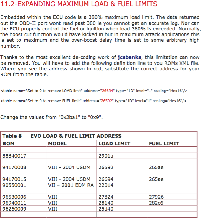

I am having problems removing the LOAD and Fuel parameters on the ECU
OK.. to be more specific
I am using Evoscan to log my rides. the maximum amount of load that reads its 103.
I need to expand this for a better tunnig .
but in my case i can't use this parameters .After re-flash the car runs but goes to lean on 1500 rpm and does not run.
obvious I don't run it like that.
hope some one show me the light !
I have been searching and can't seem to find any clue on the information > If someone know a why or can show a a tread I will Greatly be thankfull
I am using this as a reference guide
Disclamer: I don't own this information , I a m using this for reference.
Thanks
