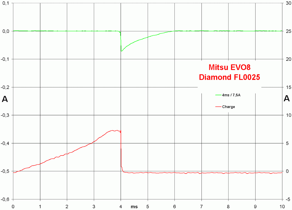

here's a link to another great article. the autospeed article is an abbreviated version of this one.
http://www.dtec.net.au/Ignition%20Co...alibration.htm
one tidbit worth noting is that the denso coils appear to have built-in current limiting logic circuit that sets the max possible output. the flat top in this coil charge curve shows that current is clamped to about 12 amps. evo 8/9 coil also appears to have current limiting logic set to 7.5 amps. output of the denso coil is mildly higher.
courtesy of jari laine

btw - those traces are not mine. they belong to a guy named jari laine. a boat-load of traces are on his picassa album page.
https://picasaweb.google.com/106058819169295752360
my crappy $500 oscilloscope produced the same primary winding charge curve for the denso coil. i was also able to monitor the square wave trigger signal.
