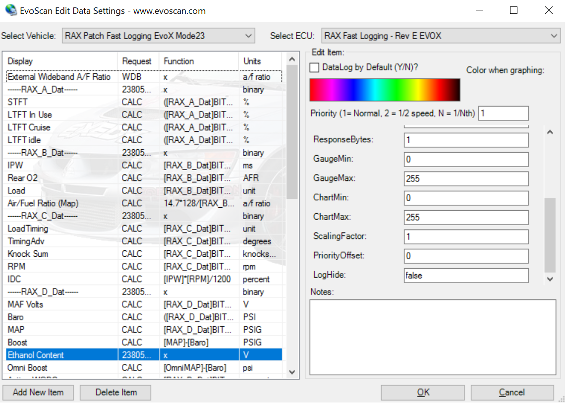

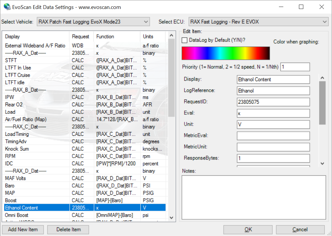

Hi all,
I'm having problems trying to log the ethanol content to get my car ready for V3
I have a zeitronix ECA that i double checked the wiring and everything looks like it's connected to where is should be (pin112 for us aussies), but when i log in evoscan, it shows a value of 95 but my gauge shows 2%. My tank should be very low on e85 so i believe the gauge reading is correct.
I removed the ECA from the equation and disconnected it from the ecu, but logging still returned a value of 95. I also checked the voltage of the analogue output wire, and that read 0.11v and matches the 2% reading on the gauge.
I'm at a loss on where the issue is - maybe i stuffed up in evoscan? here is my evoscan setting.
Any help will be greatly appreciated! Thanks.

as mentioned in email/the other forum (:P)... you need to flash V3 for that memory address to log correctly
