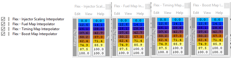

2) The average is the fed into a couple of interpolation maps:
You can see that each major function of the ECU is represented, this allows different interpolation curves to be applied to say timing vs fuel vs boost.. This should allow for a great deal of customization and trickery.
Right so once the interpolation percentage is calculated its then fed into the respective map lookups. Just like normal, but instead of a fixed output it varies between the "normal" maps and the "altmap #1"...

The interpolation algorithm will interpolate down to the single step integer level. So by not having 16 entries doesn't mean your missing out on resolution.
Making the table bigger (originally i had it a 5 big, but settled on 9) just lets you add more curve detail, which probably isn't needed anyways..
In fact for the injector scaling, my original code just had the table output a injector scaling value, but then i realised this would be confusing to tuners because the different tables would do different things.
