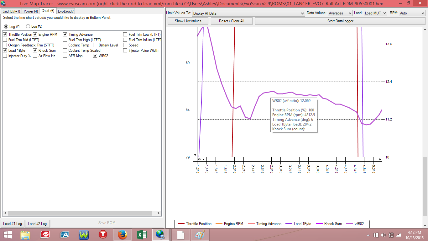

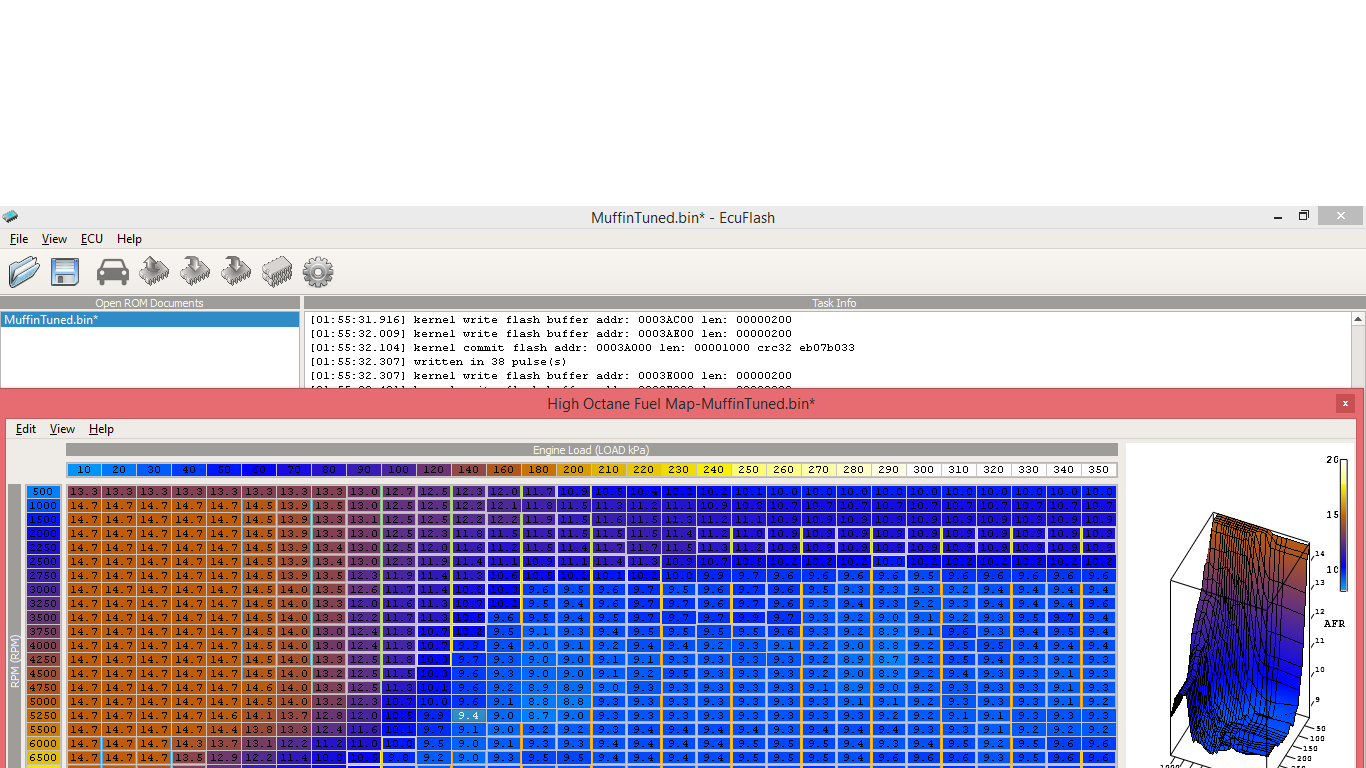

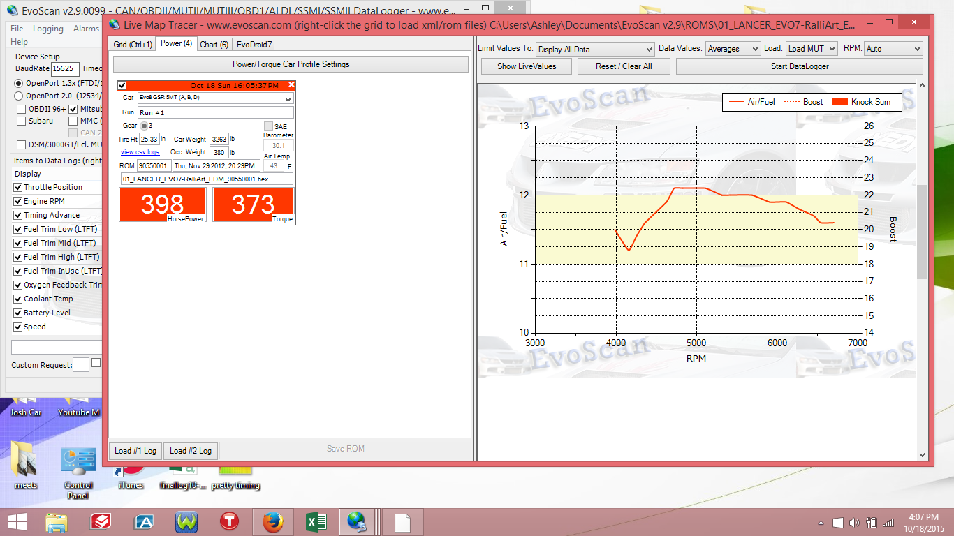

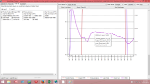

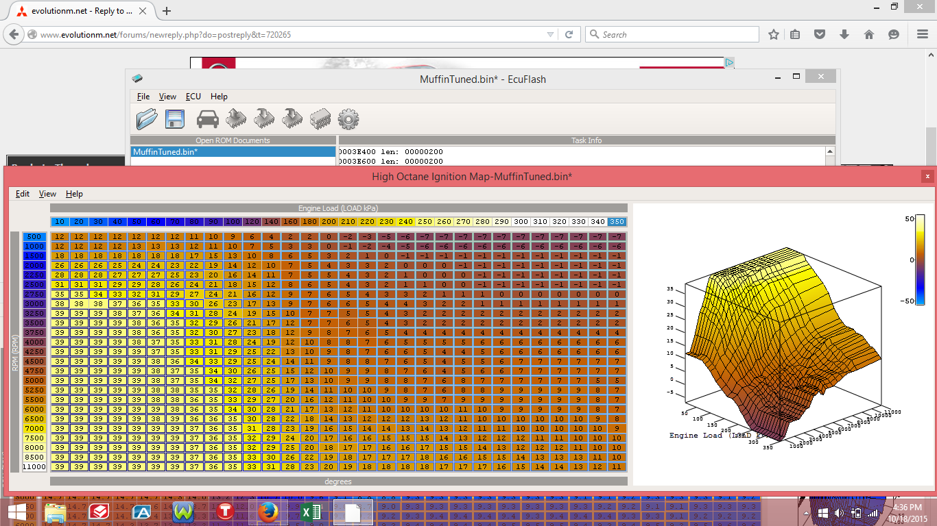

I've been having some issues with tuning my car. Specifically when rolling into the throttle getting into boost under partial throttle. I'm not sure if this is Lean Spool related as I do have it enabled.
It's been a struggle to get my air fuels smooth in that area. Sometimes the car will knock as much as 3-5 count, other times it won't knock at all. Usually when it does knock rolling into the throttle it will result in knock toward the end of the pull also. Other times it will not knock at all throughout the entire pull. Pulling out degrees of timing hasn't really done anything.
If I do a 1st-4th gear pull I normally won't get any knock at all. It's been really puzzling and hard to control. I am on E85, bpr8es plugs gapped at .018".
Attached Thumbnails Spoolup knock & AFR inconsistancy. Lean Spool the cause?-timingmap.png   Spoolup knock & AFR inconsistancy. Lean Spool the cause?-fuelmap.png   Spoolup knock & AFR inconsistancy. Lean Spool the cause?-graph1.png   Spoolup knock & AFR inconsistancy. Lean Spool the cause?-graph2.png
