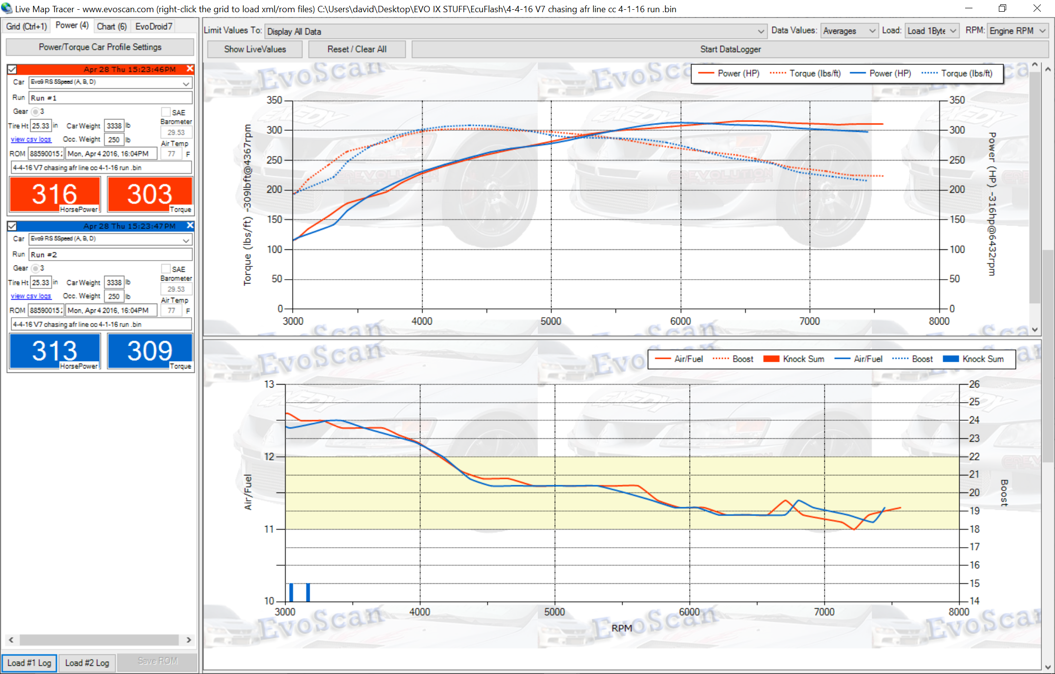

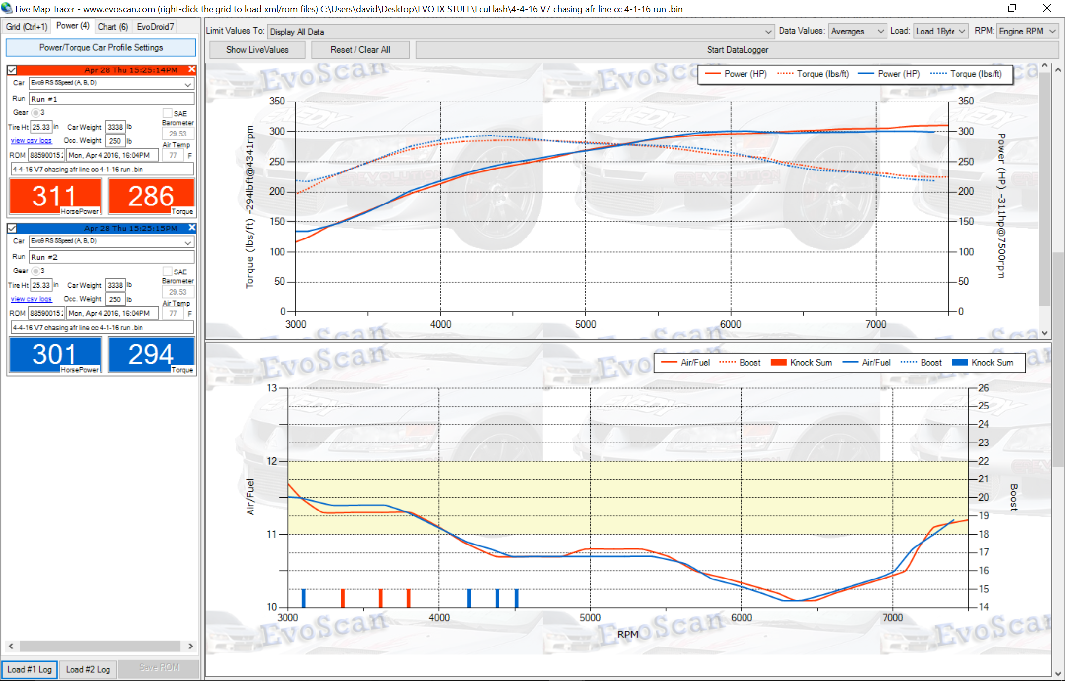

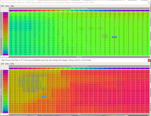

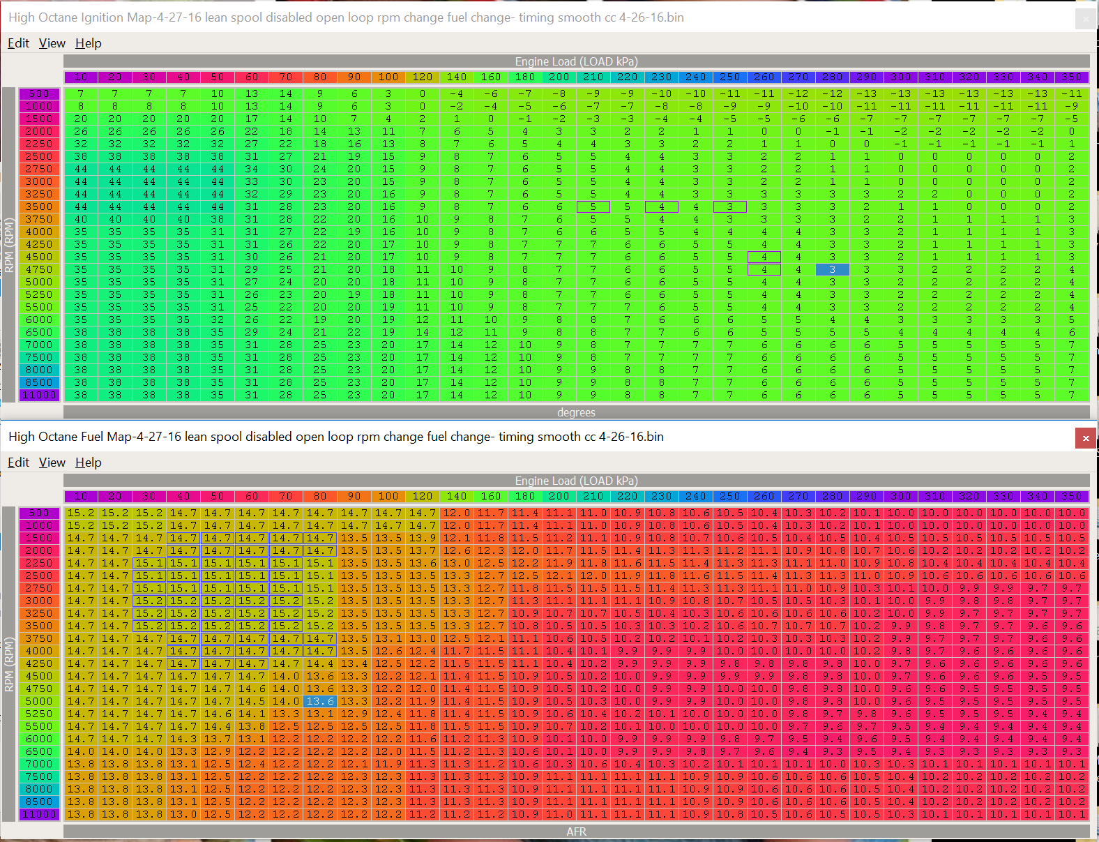

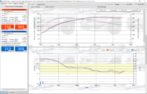

Ok here are the logs, maps, and dyno sheets. have a look. nothing changed between the fuel and ignition maps just the lean spool enabled and disabled.

i just use the map tracer in evoscan as a guide and look at the values on the log and then adjust from ecuflash to what the values should be by trial and error. it took me a while to get the afr line like that. i did 2 logs every day after work for like 3 weeks. i will start doing that for the lean spool disabled flash i have now just for fun to see how much of a difference the map would look like.

sorry i left the other logs on there instead of the WOT run only. here it is for WOT only.
