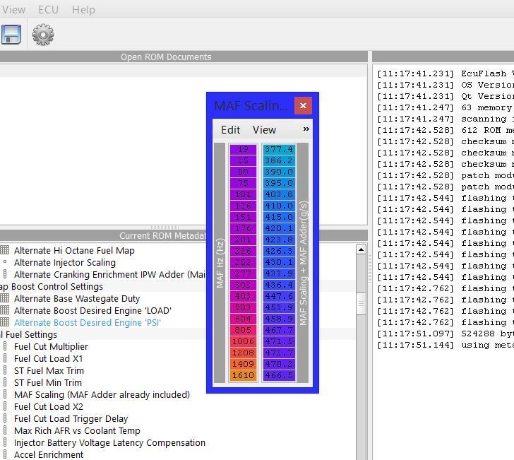

Here is what I have for MAF scaling, I bumped up 0-50 to compensate for my intake and fuel trims but ever since I replaced my front o2 sensor the fuel trims have changed. Ill rescale my injectors, latency, and MAF tomorrow.
I bumped mine up even more. Like around 19=393.7, 25=402.5, 50=421.3. Try that and see what happens.

You could try it now too. Just force the car into open loop by changing (FAA) bit 4 to 0. That will enable full time open loop. Do that and start the car. Observe AFR. Gradually increase your MAF scaling until it idles around 14.7afr or slightly richer. Then re-adjust the rest of your MAF scaling map along with the comp map to smooth it out. Once your idle is good, you should be able to switch bit 4 back to 1. Then from there, just fine tune the maps based off of fuel trims.
