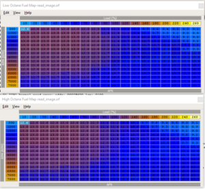

1) My MPG sucks is about 9
and I see that my low and high octane fuel map are equal here an image, its OK? How can I improve my MPG?
