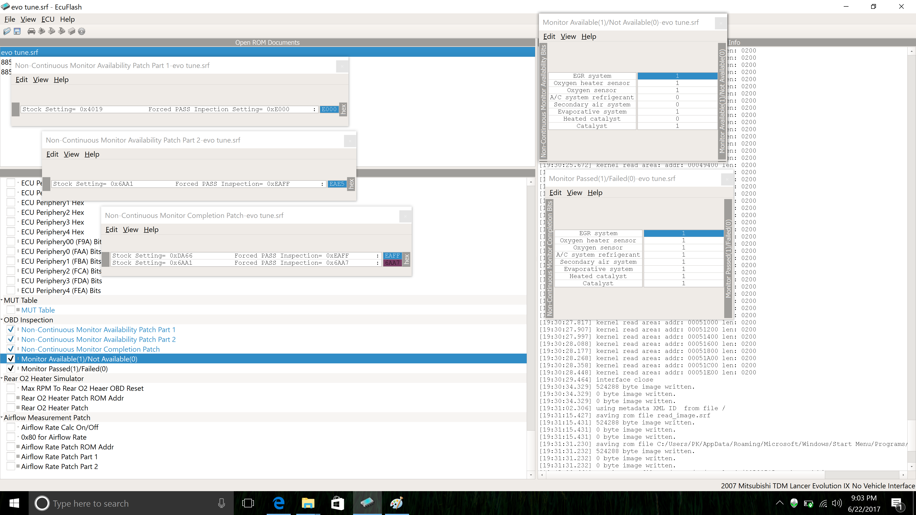

I am attaching a screen shot of my current settings that allowed me to pass several times in the past with no issues... They must have some new software on their end. One thing that is curious to me is the "eae5" for the part 2 patch. Could that be the issue?

i don't know if this is your problem, but for the tests that you have as unavailable you should also have 0's for the pass/no pass table.

first of all - what rom do you have?
second- I think you had the same problem that I had, but I solved. I need the rom number though
see my thread here....
https://www.evolutionm.net/forums/ec...l#post11603494

ROM ID is 88590715

Yeah - it looks like you have the same rom as I do.
Change your E000 to 4019 and you should be golden.
Scan it with a hand held code reader (Like I have) and be SURE your readiness monitors come out like mine before you go back to the test station.

Ok, I've made the changes and things look much better on my scanner. I do, however want a little more input before I go re test.
My scanner has a menu that I was previously unaware of that lists what is supported or not supported. Everything is listed correct except catalyst... It is listed as "not complete" instead of supported/not supported like all other items. Under the drive cycle menu catalyst is listed as complete fwiw...
Also changing the pass/fail menu to match the available/not available menu results as the items not relevant to the car being listed as "not complete". When I have them all set to "1" (pass) those items, are listed as "complete or n/a". What settings do you think make the most sense?

I've read your post a few times and it's sorta confusing- maybe it's the wording. Why not show me a picture or make a video of what you mean?
You need to stop worrying about the "1's". For some reason the program (ECU Flash) does not show correctly with regards to this on our evo 9's. My evo 9, and another Evo 9 (some guy from California, I forget who) had the exact same fix. I think you will be number 3.
As far as "not complete" I am a little puzzled. Drive it a little more and see if this becomes complete.
I am by far not the most knowledgeable person to discuss this with. I highly suggest you start posting in a more relevant thread - IE the one I was posting in.

I agree, the wording is confusing. Im at work and don't have everything in front of me but let me try to clarify.
So in the 1st paragraph about my supported/not supported menu. The O2 sensor, heated 02 sensor and evap is all listed as supported. The heated catalyst, air and ac are listed as not supported. The catalyst is listed as "not complete" when I believe (in this menu) it should be listed as supported (or not supported). This is not the same as the drive cycle. Catalyst IS listed as complete in the drive cycle menu.
In the second paragraph, I am thinking that if the pass fail menu is matching the available menu with O2,heated 02, evap and catalyst listed as 1 and heated catalyst, air and ac at 0... The drive cycle menu lists the 0 items as not complete and I'm wondering if that could cause a conflict with their scan. To me it makes more sense when they are all at 1 because the scanner then lists those items as complete or n/a... The n/a is the part that makes more sense in my head than "not complete" for heated catalyst, air and ac.

I passed the test yesterday.
Hooking up to my wife's car I got the same confusing "not complete" under the supported/not supported menu for catalyst. Also under the drive cycles menu the not supported items for her car were listed as complete or n/a.
With that logic I left the pass/fail table as all "1" as I had it before. Really the only change I made was the one suggested change to "4019".
