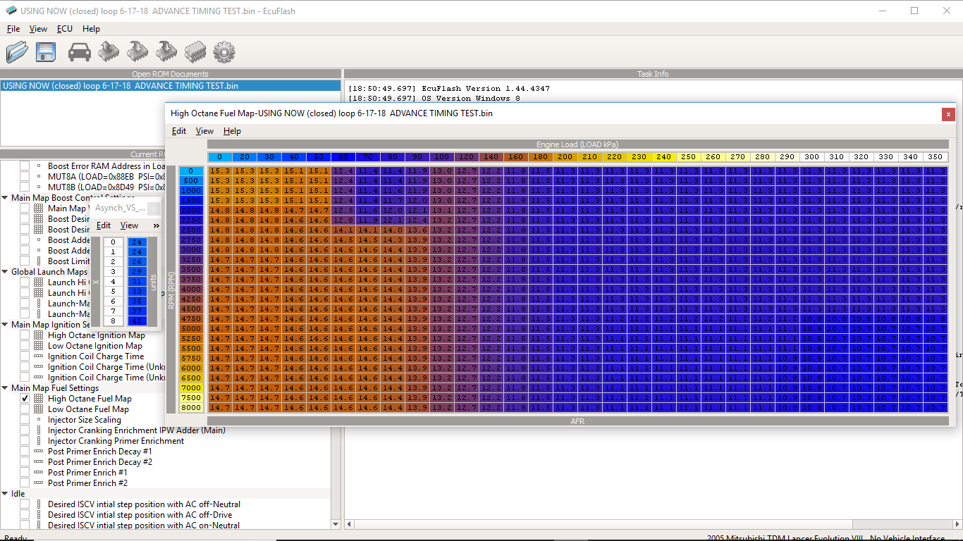

Hey guys i have an evo 8 with full bolt ons on sd. I have it running well but when i go to closed loop it has the dreaded lean tip in. I tried async vs tps delta and tried richening up 60 - 90 load area on fuel map. I went as far as to drop it to 11s in that area. It does it most when taking off from a stop. It doesnt always do it. I guess it depends how much gas you give it. If you watch the wideband it always goes to the lean side when taking off. Most of the time is bareable but sometimes it just feels like you hit a wall and wideband goes full lean. When it does this i can usually give it gas and work through it in a few seconds but this sux. Its also pretty dangerous if youre turning and theres traffic coming. If i leave it in open loop it will be fine but i want it to work in closed loop. Im running 9417 sd rom. Any ideas what else i can try?

Post your SD tuning tables. I'm guessing the load isn't high enough in the 30-100kpa range.

Here you go. Car runs great idling, cruising, wot, etc. Havent wanted to change anything so it doesnt mess everything else up. Im guessing it has something to do with that 78 at 1000 rpms in the sd rpm table. But if i change that it will mess up my idle.

I would bump up the 50~ 70kpa and 90kpa 5 Points and see if that helps the issue. Shouldn’t affect idle. Sounds more like the 70~90 is where you need to adjust.
This might richen up your Cruze areas some but see if that works on the hesitation first.
